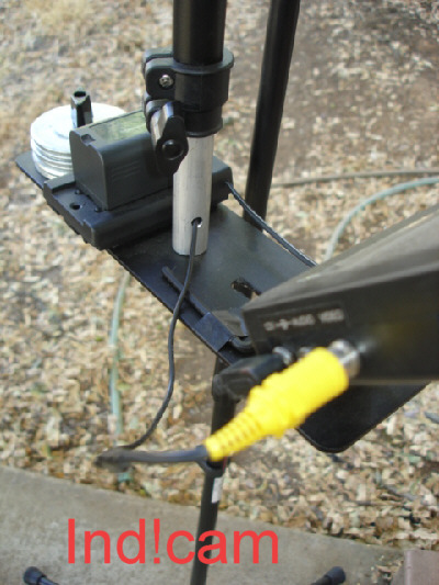

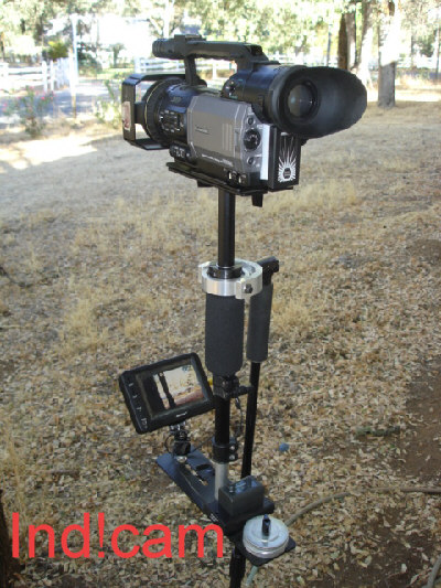

Terry, is there the ability to mount a small monitor...like the panasonic 7inch to the sled...and still be able to balance it? I'm sorry but I don't know much about your product so I'll claim ignorance here! Can the rig be set up to power items from it like maybe by mounting a battery bracket to the base of the sled...maybe underneath? Possibly Anton Bauer Dionic 90 or some slim Lithium Ion power source to run camera and monitor? These powerful batteries are pretty light these days and they'll run a camera and monitor for a really long time. Can cable be run up the center post or is it solid? Or am I making the product too complicated?

Ken,
Attached are two pictures. One shows the PILOT system with a Nebtek 5.5 inch monitor and Panasonic LiIon battery. We bought the Nebtek because it looks great in full sun. This configuration is harder to dynamically balance because of the weight differences on the bottom plate but it can be done. What we do is spin the sled without the camera platform on and work on getting a non-wobbly spin (equal weight on either side of the post). Then we put the camera stage and camera on and do a normal balance.
The second attachment shows the video cable coming out of the post.
We had to make sure it was long enough to accomodate an extended post.
Our own preference is to use the side mounted monitor as that is what we are comfortable with but you origonal Steadicam guys are familiar with the bottom mounted monitors.
The answer to your questions is...where the is a will there is a way. We don't sell the PILOT with the bottom mounted monitor but it can be adapted as long as the increased weight is in our range.
