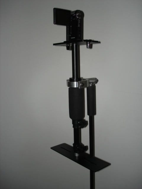

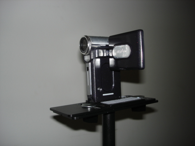

To come to Glidecam's defense (though they don't need it), they do the job they were intended to do and you can get some great shots while using one of them. For the bigger cameras you will need a support system. You are also correct in that there are some things that could be improved upon in the sleds and that's why we made our PILOT sled. It holds heavier cameras like the 4000 does but will also balance and fly 1/2 pound cameras. (Pictures to follow)
The 2000, 4000, and PILOT all have the same sized handles so the Smooth Shooter can hold our PILOT sled and our support system can hold either the 2000 or 4000 sled.
Attached are a couple of pictures of a balanced 1/2 pound (very small) camera...
With this small video camera I am able to shoot a lot longer because there is so little weight involved. Anything much bigger would need counterweights on the bottom plate and much more effort to hold it. If we're talking professional video then I would of course use the support vest and arm because of the sled and camera combined weight
I wish I could show the video from this small camera as it looks fairly good but it's an .AVI file.
By the way-for those who don't know-the Bodypod is for static (not moving)shots . The Forearm Brace will help in the moving shots for any who can't affort a support system......Yet. It will give you some extra shooting time but not like a support arm will.
