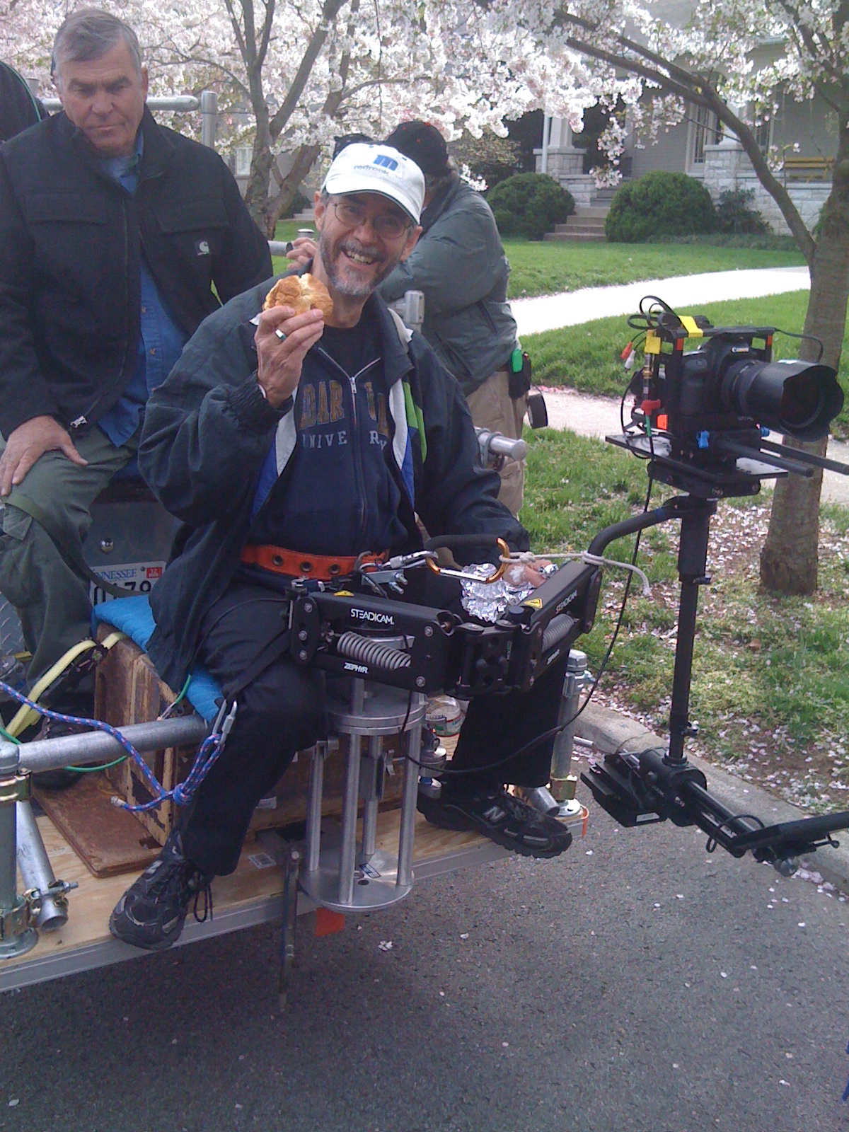

Did an outdoor vehicle shot with the Zephyr today. The rig performed very well, but, as for the monitor, I was lucky that it was cloudy.

There is no "legal" definition of daylight-viewable. Nits don't count for much if the monitor has a shiny, non-coated surface that reflects everything around you.
Sometimes, the worst scenario (even worse than daylight) is a fully overcast day, where the sky is all white. That can be a real bear for any monitor as a reflection.

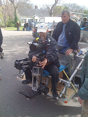

Nice vehicle mount Mark. The perspective may be a little confusing but it looks like the arm is hardmounted to something next to the Mitchell riser rather than the riser itself??

Nice one, Mark! Was it your own vehicle mount or did that come with the production/camera car?

The arm is connected to a Garfield mount directly to the Mitchell riser. I previously bought a used Garfield mount and added a Flyer/Zephyr/Scout/Pilot female socket block to it. About $100 for the socket block part number 803-7801. The riser and ubangi and platform were rigged by the Key Grip and provided with the camera car.
As for the monitor, my feeling is that they basically ARE selling it without a monitor. :-) By that I mean, they put their parts and engineering money into the other components to keep the selling price down to $8995.
It's a decision I'm not wild about but I can understand (what I presume to be) their thinking.
At some point, our choice becomes whether to spend a lot of effort worrying about it rather than devoting that time to getting work with the rig. A day or two of paid operating can pay for a pretty sweet replacement monitor. Not that it's not a real issue and irritant.
That doesn't mean we shouldn't voice our concerns, but ultimately its not an un-solvable problem. Just something to be aware of when considering the rig purchase.

Yes, that all makes sense Mark--if you look at the previous pic, it seems like the arm is mounted significantly to the right of the riser, it's an optical illusion. Good safe setup you have there, you hit all of the things I used to call for on a vehicle mount (waist harness, foot support, safety attached to handle for runaway rig, spare croissant etc).
Always a hoot to see all that hardware in service with a DSLR looking dwarfed in the process!

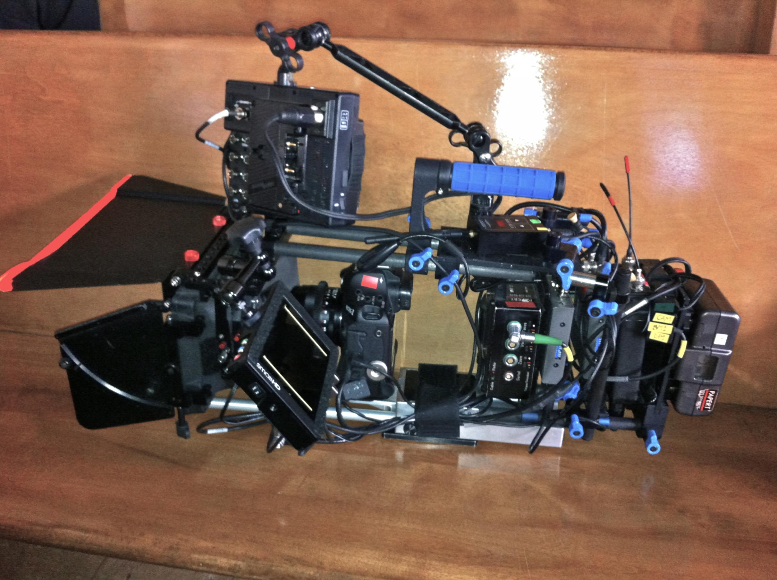

FYI here is my 1DMKIV buried in shooting setup for the pilot I just shot...

Lessee: left to right:
O'Connor O-box
1DMKIV, Zeiss ZE lens (Duclos gear mod)
Small HD 5.6" for operator
Marshall 7" for AC
Preston focus motor (hidden behind Small HD)
custom baseplate (fore and aft rods telescope separately)
Redrock handle
Dynawave SD transmitter (under handle)
Preston motor driver
Blackmagic HDMI to HD-SDI converter
Blackmagic HD-SD downconverter (for transmitter)
Wireless audio receiver
Dionic 90HC
The audio receiver was a send from the mixer as network dailies were being struck from the original files, with the transcoding and syncing done a day later. Surprisingly the dailies sounded really good, I never heard any AGC issues.
Total weight was probably 23 lbs.
