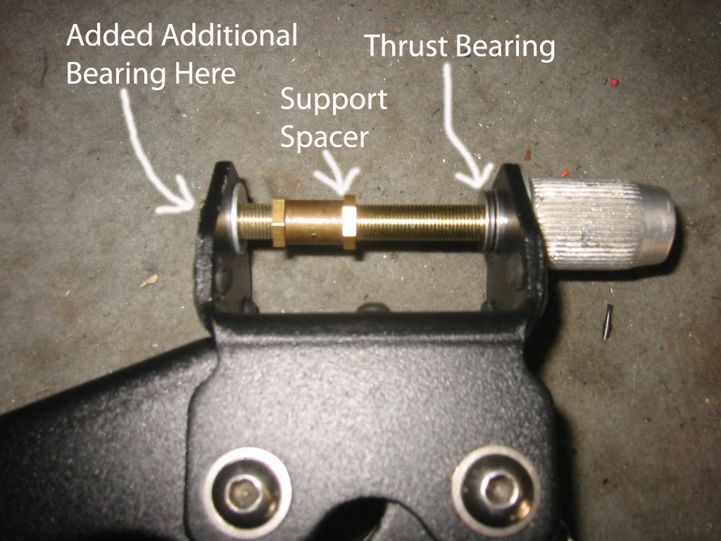

One of the first "mods" owners of the Indian made flycam are doing is scrapping the fixed post as supplied from the factory and adding two flange bearings so the post can rotate !!
It certainly seems to be an essential that it's reasonably smooth too ... I found (when I still had the rig) that it makes a huge difference and is really a simple thing to do!!

Hi Robert
Here is one from the HBS site to give you an idea
Chris
simple question for pilot/flyer other steadicam owners-armmod2.jpg
