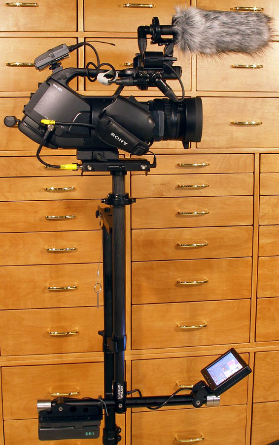

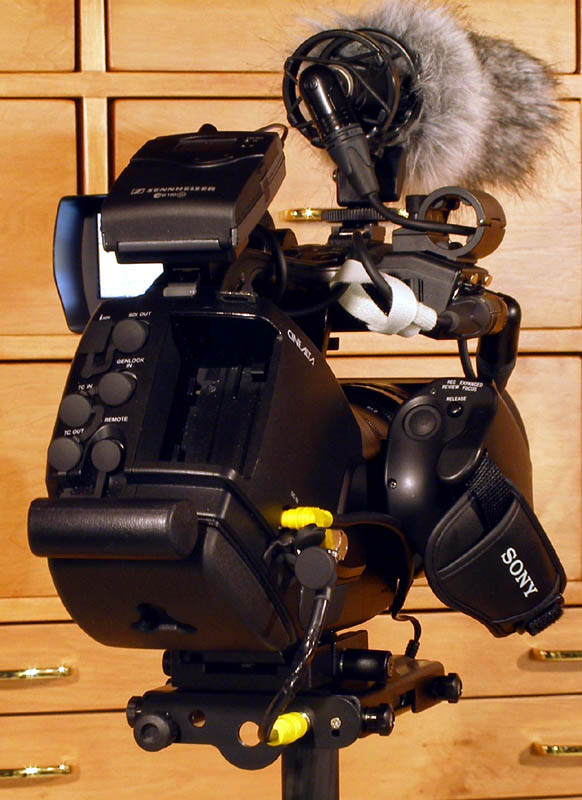

1) Yes, the Flyer includes a hard case and a balancing stand.
What's in the Box
Steadicam Flyer-LE Camera Stabilizer System Camera Mounting Chassis (Sled)
Dovetail Camera Plate
Center Post
Iso-Elastic Camera Arm
Standard Vest
Color LCD Monitor
NP Type Battery Mount
Docking Bracket
Tiffen SteadiSTAND (fits inside case)
12 VDC Power Cable
3' Lightweight BNC Video Cable
BNC to RCA Adapter
RCA to BNC Adapter
5/32" T-Handle Allen Wrench
Hard Transport Case
Instructional Video
Owner's Manual
1 Year Parts and 6 Months Labor Warranty
Steadicam | Flyer-LE Camera Stabilizer System | F24LENPNN | B&H
2) All Steadicam arms are no-tools adjustment. All Steadicam arms are iso-elastic. Only the high-end Steadicam arms (G-50 and G-70) have a "ride" adjustment.
3) Flyer arm is 30" boom range.
4) Glidecam gimbal is good, but the Steadicam gimbal is super-precise. If you can balance the rig without touching it, when you walk around the sled, the Steadicam just sits there. It's basically friction-less.
By the way, if money is an issue, you might consider the Steadicam Pilot. I've use the Pilot with the Sony EX3, plus a shotgun, wireless lav receiver, and a wireless video transmitter. As long as you remove the LCD EVF hood and use the Pilot's battery to power the EX3, it works fine. The 3 links below show pictures of this setup.
http://www.dvinfo.net/forum/attachme...ped-ex3_1s.jpg
http://www.dvinfo.net/forum/attachme...ped-ex3_2s.jpg
http://www.dvinfo.net/forum/attachme...ped-ex3_3s.jpg
Dave Gish is offline   Reply With Quote
