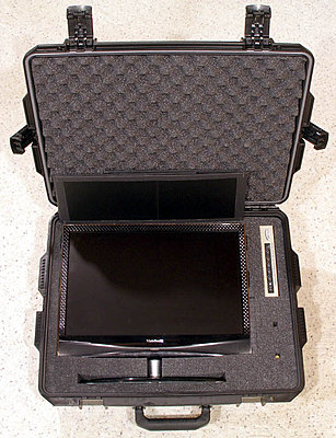

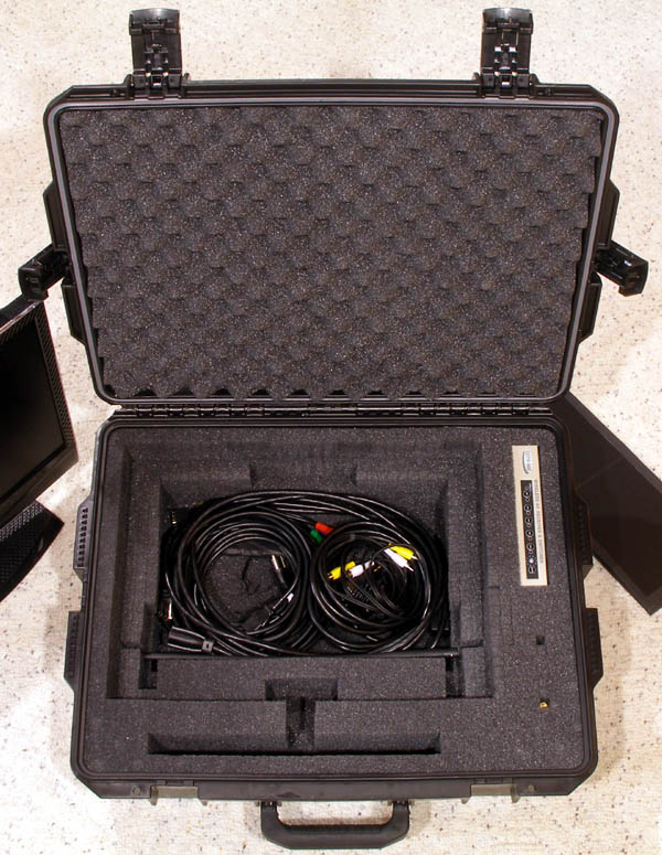

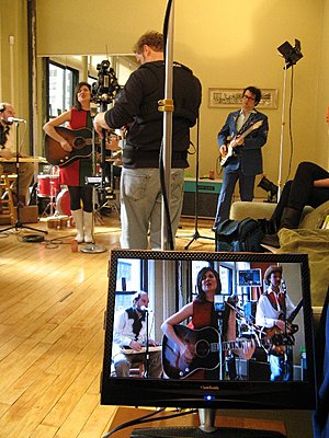

I think my immediate solution would be to use the merlin and the 3" screen on the camera for framing. I can then connect it to the 10" LCD to verify the shoot before wrapping up for each scene.
For this type of stuff, I use a 19" LCD. Costs less than $300 and fits perfectly in a Storm iM2700 foam case. Looks great in HD using component video cables. Also has HDMI.
This also works good for tripod shots just sitting on the floor tilting up. I just gaff tape it to a tripod leg and the floor to get the right angle. I also made a hood out of black coroplast, gaff tape, and velcro. Coroplast is great for all sorts of things.
I also use this in SD mode as my wireless video monitor.
Flying with 10" HD LCD?-monitor-case-1.jpg   Flying with 10" HD LCD?-monitor-case-2.jpg
