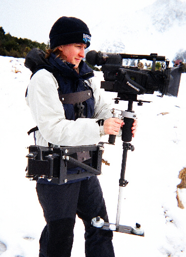

Denise,
We just returned from a long business trip to the South Seas so I'm 31 days behind on this forum.
Charles P. mentioned that we at Indicam might have an arm that will fit the Merlin sled and indeed we do and have been selling it to various customers around the world. We even have a special "Barbie" sized vest for very small individuals. We made one for a young lady in Australia (picture attached) and decided to make an extra just in case. Although she is very petite she said the system worked great for her.
Our arm will work with both the Merlin and JR, as well as our Indicam sled with an inexpensive adapter. Our sled will also work with the Merlin vest with the before mentioned adapter.
When you get around to needing a support vest and arm system let us know and we will see how we can help you. We like to take good care of our customers with personal interaction.
Best of luck to you! You've chosen a great place to gather information.
