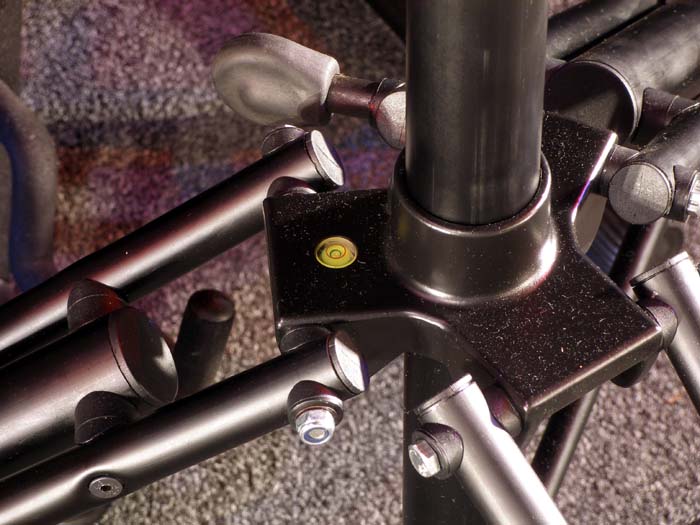

Anything that works as a stand will get you by for now, but the first time you take your gear on the road, you'll wish you had the SteadiStand.
The SteadiStand is:
- really light weight
- very stable (no sandbag required)
- collapses very small
- has a bubble to get the post vertical, which helps a lot with static balance (see picture)
- comes with a small cloth case with a strap.

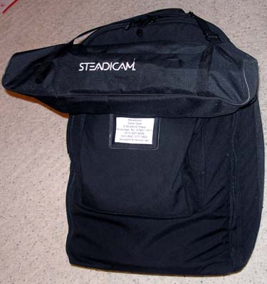

I use a couple of black tie-wraps to attach the SteadiStand case strap to the top of the Pilot backpack (see picture). That leaves my left hand for the camera case, and my right hand for the wireless monitor case.
