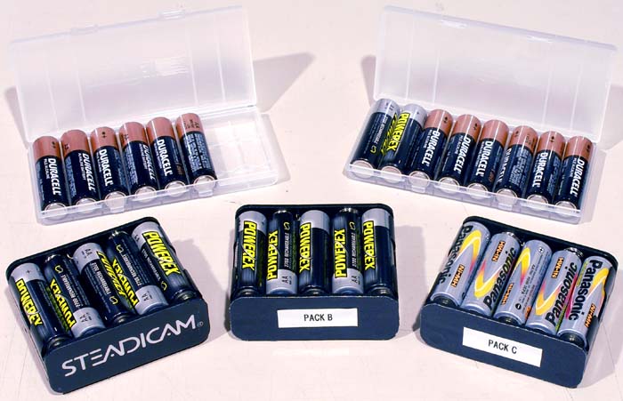

With my current setup, the arm is level with a little thread room to spare. Not counting the battery, my stuff weighs exactly 9.9 pounds. If you count the 10xAA battery pack, the weight comes to 10.6 pounds. So I guess there's a little extra margin with the 10 pounds.
For those who haven't seen the AA packs, I've attached a picture.
Dave Gish is offline   Reply With Quote
