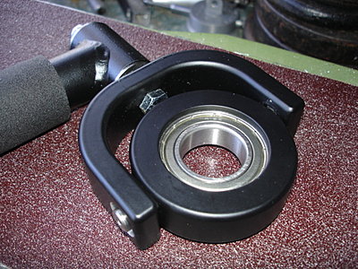

You must have Indicam mixed up with some other manufacturer as our arm system (dual instead of single) and sled are silky smooth, very robust, and just work. Our system was in pre-production before the Smooth Shooter came out but we didn't release it for sale for a couple of years to make sure it was the way we wanted it to be. We know and respect (and like) the guys at Glidecam and feel their products are very good. Still, we feel we have some designs that make our system a great value. We have a new gimbal which is made by a different machinist and it is real nice. Attached is a picture of the new gimbal. Hope to show Charles at NAB.
If you come to NAB this year we'll let you try out a system so you can make a comparison based on actual use.
Charles, FYI...our 214 arm uses either one or two sets of springs which can be changed within a matter of seconds. I know you want to keep current. Say Hi to Amy.
Tery
Indicam
