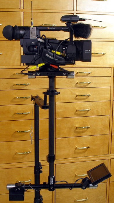

After adding a new accessory to my camera i of course had to readjust my balance. When i was playing with the stage adjustment i heard what sounded ALOT like sand or dirt in a lens.. we all know the sound.
I thought at first that somehow i'd managed to get along the back and forward and side to side adjustment tracks on the stage.. upon taking the top plate off the stage i discovered it was actually the screw that was holding my Manfrotto QR plate that was the problem.
The bottom of it, where the slot for your flathead screwdriver goes into was rubbing against the where the top of the post meets the stage.. No real damage has been done apart from a couple scratches so all good.
I went back and found the screw that came with the pilot and noticed that the flat part is a lot thinner than the one that came with my QR plate.. i didnt use the pilot one because it was too short to screw all the way up into the manfrotto plate.
So time to find a replacement. Just thought i'd post this up incase anyone comes across this in the future..
I had the exact same problem.
When I first got the Pilot I was using a smaller DV camera, so I added a weight plate under the camera to make it fly better. I used a longer 1/4-20 screw to go through the weight plate into the camera. The longer 1/4-20 screw had a round head, so it ended up scraping against the inner part of the stage.
I solved the problem by filing down the head, and then carefully removing all the metal filings with a shop-vac. No permanent damage, but you can still see some cosmetic scratches when the top plate of the Pilot is removed.
Now I have an HVX, but I still end up adding extra weights to the stage to make it fly better:
Steadicam | 801-7920-05 Middle Balance Weight
(click on the attached photo below).
