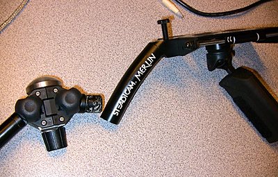

Looking at the Merlin footage I decided (thank yhou guys) to get one.
Except for the fact that it just felt apart the first day I brouht it home, it's a very ncie piece fo equipment and much easier (compare to Glide\Fly Cam)
to work with.

thats an US$800+ piece of equipment, quite high-priced and for it to fall apart on you think is completely unacceptable, especially considering Steadicam's history and reputation and the fact that it's way more expensive than its competitors - the engineering & construction of it *should* be 1st class.

Call the factory at 818-843-4600 extension 17, talk to Kyle Young.

Second, i believe they have lifetime warranty, i'm sure Tiffen will take care of you in regards to a busted unit...

Yup, a quick call to Tiffen/Steadicam will fix this immediately.
Part of what you pay for with Steadicam is that in the rare case that you do have a problem (keep in mind that they have sold LOADS of Merlins, and every process is subject to an occasional problem, so the % with a problem seems to be really low) is the top notch support you get when you need it.

Thank you guys,
I wanted to bring it back, but they would send it back to manufacturer, and I didn't want to waist a few weeks on waiting when it's gonna come back, I wanted to put my hands on it right away, so I just glued it with super glue ;-)
now it works better than new, when it was new upper spar was shaiking and turning, now it's solid, the way it should be!
Yeah, I know, it's kinda suks, but I love the piece anyways, it's just great!
Now I'm thinking to get an arm and vest, hopefully that will not brake, at least for the first couple weeks :-)

Buba, if you insist on rapiring it yourself; check the small "set screw" in that joint to make sure it's tight and doing it's job.
