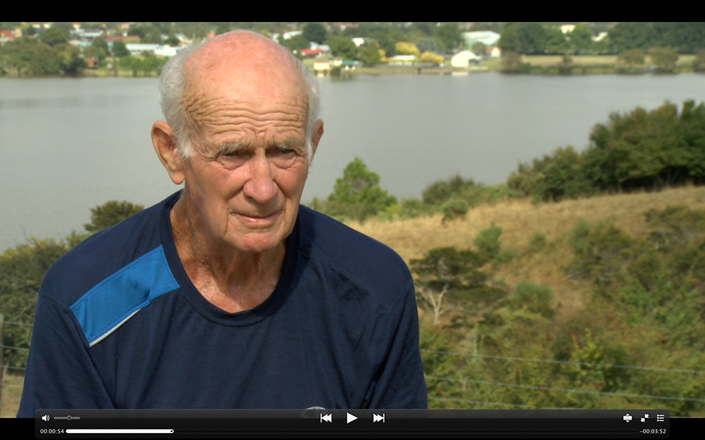

For the outdoor IV, I placed the subject on a slight angle so the sun lit up their face but so they weren't staring directly into it. Then I used my little 96-LED light mounted on a tripod to fill the slight shadow on the other side of their face. The eye sockets are a little dark but otherwise not bad.

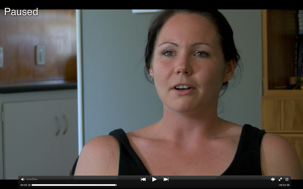

For the indoor IV, I placed the subject facing some open windows then used my LED light to fill one side of the face. Would have been nice to have another LED to light the other side though.
The end result is something I'm reasonably happy with. But I'll let you guys be the judges (pics attached).
Definitely have a lot to learn about lighting though. Looking forward to reading more tips. Thanks guys.

In my opinion, for what it's worth, I think you've done better than you did in the 5 Finger Shoes Promo.
However, I think there are a couple of things to nail;
Subject one,
a) Your camera is elevated in regards to the subject, He has very bushy eyebrows, you need to drop a little to see his eyes. It also gives a better perspective, not a 'I'm looking down on you' perspective and allows a better view of his eyes. I don't know what the interview is about but I'm guessing it's a little more substantial than an ENG crew outside the courthouse yelling" Sir, sir, is true you got away with a claim of 33 million dollars for corporate lunches this year?" No-one really cares about the person as they scurry away, the audience really only wants to hear the answer. Here, you want the audience to connect with the subject and to do so, we need a clear view of his eyes, and to be on the same level.
If your interviews are all with "normal people in normal circumstances", eye level shots would be best. If your interview is with a "normal person hanging from a karabiner on the side of Mount Cook" shooting from an elevated position is great as it shows you're all hanging off karabiner’s on Mt Cook and it's 300M to the bottom. Make sense?
b) Try and pull in closer to the subject, your interviewing him, not showing us the background scenery. Keep it tight.
c) Your highlights are a bit blown out but you're getting closer, well done.
d) Your positioning of the subject is far better than the second subject in the 5 Finger Shoes Promo. Well done.
e) I may be wrong, but I think your focus is a little soft.
Now, could you have moved the subject to shade or were you stuck with where you were?
Subject 2;
a) Lighting is getting better, use of natural light is good. Your highlights are still a tad blown out, but definitely better. I don't think you need a second LED.
b) Focus seems sharper.
c) Is it imperative to show the background, not likely. Centralise and tighten the shot, but tilt up a bit because the top of her head is missing.
d) A little light on the eyes gives life to your subject, well done.
Maybe make up a little pocket sized prompt sheet for yourself.
Subject;
1. Position relitive to the sun.
2. Background.
3. Height.
You;
1. Can I put subject in light shade.
2. Location
3. Eye level.
4. Don't chop head off.
5. Contrast of clothing in variance to skin tone.
6. Keep shot tight. (this will help with over exposure on skin tones due to high contrast clothing.)
OK, well done for getting out there and having a go.
Al

Overall I agree with Alan. My one rule (unless it something special I'm going for) is the center of my lens should be just about the same height as the subjects eyes. Now that is not a 100% hard and fast thing but for me, it's a good starting point. Also unless you the background is going to help tell the story or is an iintergal part of the story I try to keep as much of the background out as possible either thru framing or DoF or both...
I disagree a bit with the head being chopped off. SOMETIMES it's OK to do that BUT if you are going to do it, make sure it's for a good reason and don't make it look like you did it accidentally. In almost all case keeping the subjects head in the frame is a good thing to do so I would stay with that unless it's specified to cut it closer.
Otherwise overall, it's pretty good and get's you going in the right direction. Stuff like this takes practice like doing anything else in this business, the more you do it the better you get.
