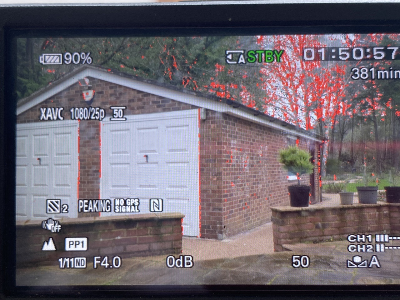

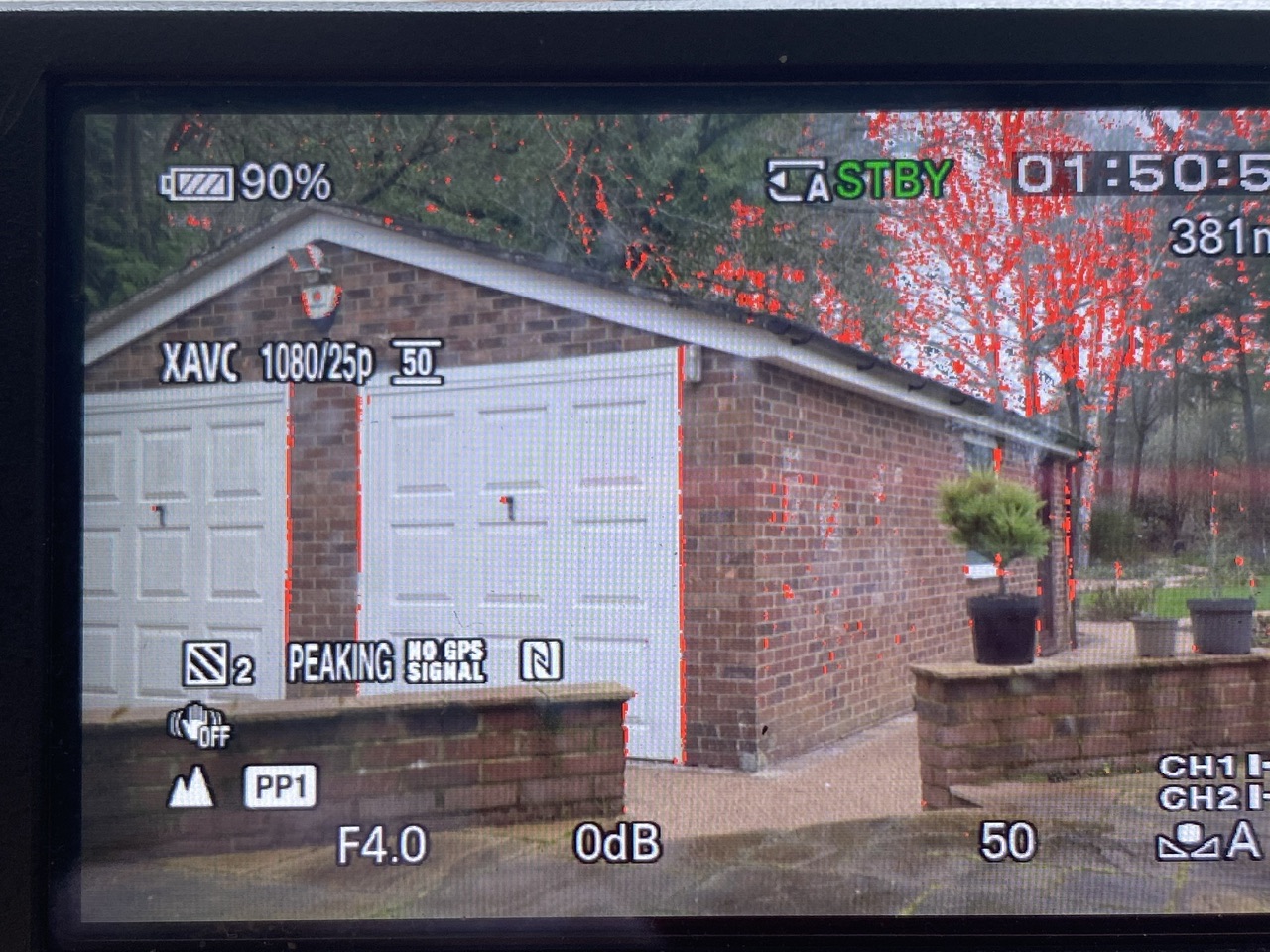

An update after a protracted absence …
“Auto ND” now functions correctly, almost … My only issue is that when “Auto ND” is on, I don’t get the value of the ND filter with an “A” symbol in the VF. There no indication of the ND value at all. If I switch “Auto ND” off, then the ND filter value is displayed. Images show the VF with “Auto ND” switched off and then on. I’m on firmware version 4.03. |
#9 |
Location: London UK
Posts: 103
Re: FS5 Auto ND
Fixed.
I had “Camera Data Display” set to ‘Off’. |
