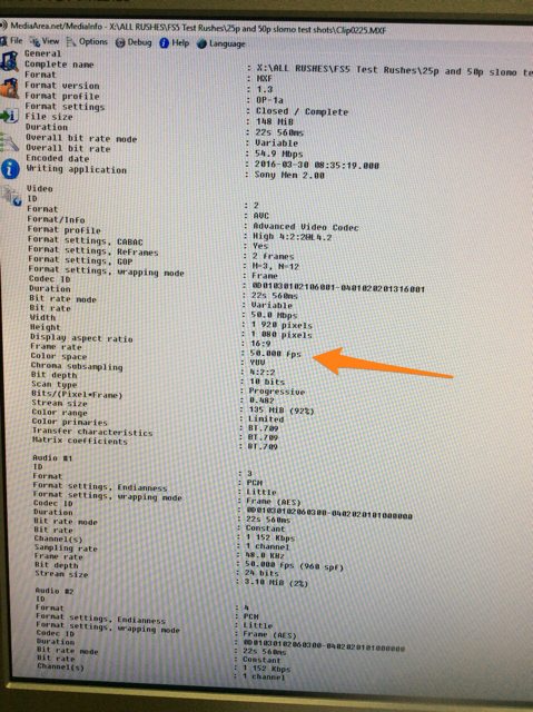

Nigel if you have the time could you possibly run a 200fps clip through MediaInfo and see what it says? Just go to View and select Text and you will have the entire clip structure in front of you
https://mediaarea.net/en/MediaInfo
Only if you have the time as I'm curious.
I just checked the 700 again plus checked the footage on the timeline. The camera is definitely scanning at 200fps but it buffers it out and records it as 25p.
Chris Young
CYV Productions
Sydney

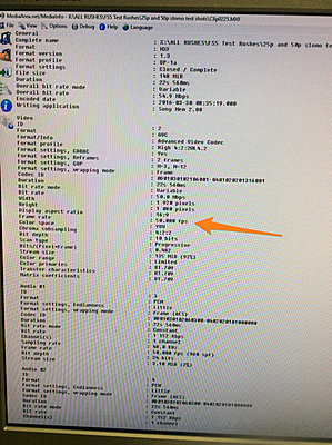

Hi Chris I did what you asked with MediaInfo and the frame rate is definitely showing at 50fps for the 50p clip at 200fps. Likewise I also recorded a 25p 200fps clip and it shows as 25fps in MediaInfo.

Thanks for that Nigel. Just confirms my belief that the the overcrank settings although having the same fps available in the FS700 and FS5 are quite different as MediaInfo definitely states 25p for the 700 when running a 200fps.
