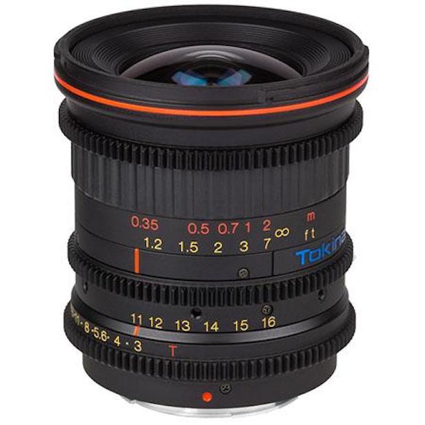

Any thoughts on the Sony 10-18mm f/4 vs the Tokina 11-16mm f/2.8? There is a "Cine" version of the Tokina 11-16 in EF that has an iris ring on the lens. But I keep hearing that the Tokina 11-16 is soft and near unusable at anything but an f/11. The Tokina 11-16 f/2.8 on the Fs7 using the metabones ultra adapter is an interesting thought since the result would be a 11-16mm comparable 35mm equivalent speed-boosted to f/1.8. ( the metabones adapter would essentially negate the "crop factor" of S35. The FOV would be much wider than without the adapter. Wider than it would be with a simple EF to E mount adapter. Wider than any use of the Tokina 11-16mm on an F5. )

The Tokina 11-16 f/2.8 on the Fs7 using the metabones ultra adapter is an interesting thought since the result would be a 11-16mm comparable 35mm equivalent speed-boosted to f/1.8. ( the metabones adapter would essentially negate the "crop factor" of S35)
FWIW, the Tokina 11-16 is an APS-C/S35 lens, so there will probably be vignetting at wide angle if you put it over a speedbooster.

" But I keep hearing that the Tokina 11-16 is soft and near unusable at anything but an f/11."
I don't know where you've heard that. I thought it was supposed to be comparable to the other lenses. i've had no problem with it. For 18-35 the best lens out there is supposed to be the new Sigma f1.8 . i assume there is an E mount.

Do you think the Tokina cinema 11-16mm EF would vignette with ANY EF to E-mount adapter or only with the metabones?

There is extreme vignetting on my Tokina 11-16 (Nikon mount) on the wide end, but 16 looks fine via the Metabones speedbooster Ultra and will be plenty wide and useful anyway.

the 11-16 will not vignette with an ordinary EF or Nikon > E mount adapter. Only with speed booster because that is made for full frame lenses and 11-16 is made for APS C.

So a possible zoom lens package that features zooms with manual iris on the lens, and only zooms with manual iris on the lens, would be:
Tokina 11-16mm CINE EF ( using simple EF to E-mount adapter )-
