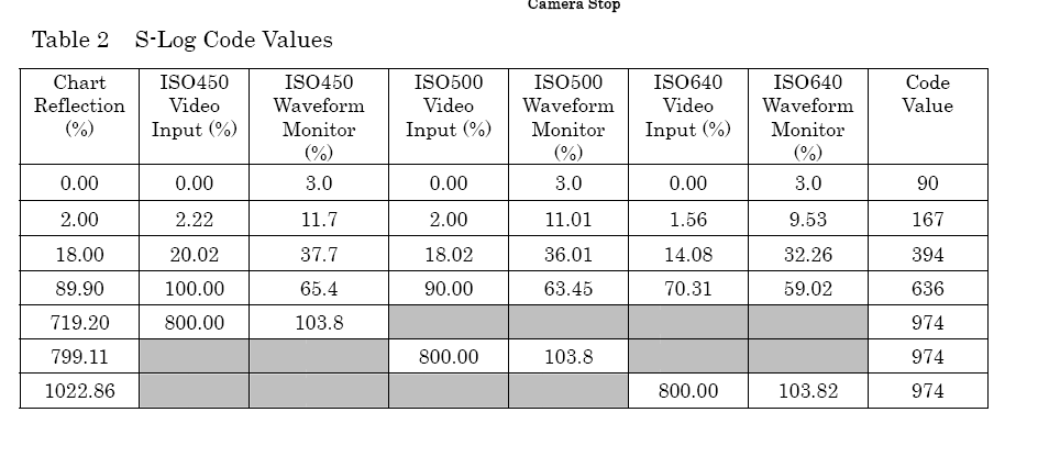

Attached is a snipit from the Sony's white paper on S-LOG. The values for 18% and 100% are shown in the image.
Obviously we all have to work in the real world so we aren't always able to adhere to design criteria but it is good to know what it is so we can understand the risks we take when we exceed it.
You can reference the complete white paper here - http://www.sony.co.uk/res/attachment...7476953066.pdf

When your dealing with a good quality mid grey card (18% reflectance) and a white card (90% reflectance) in S-Log if you put middle grey at 38%, then white will be 68%, if it isn't then you middle grey is incorrect.
The contrast ratio between white and middle grey never changes, no matter how bright or dark the scene the middle grey will reflect 18% of the light and the white 90%, so the brightness ratio between the mid grey and white always remains constant, white will always be 500% brighter than mid grey. So it doesn't matter how bright your scene, with the S-Log curve, if middle grey is 38% then white will be 68%, 500% or 2.5 stops brighter than middle grey, always is, it's a reflectance ratio and the difference between mid grey and white will always be 2.5 stops which on the S-Log curve puts white at 68% when mid grey is 38.
You don't want to over expose with S-Log. It is highly compressed, if you over expose faces etc you risk putting them in the highly compressed part of the log curve and this makes it very hard to recover a decent looking image. You really need to keep faces and skin tones at least a stop under white, so faces need to be down at around 45-50%.
Do consider that when you look at the Sony S-Log graph linked to in this thread that the horizontal scale is stops, so it is a Log scale which is why the plot looks like a straight line. If the horizontal scale was linear the compressed nature of the curve would be obvious.
