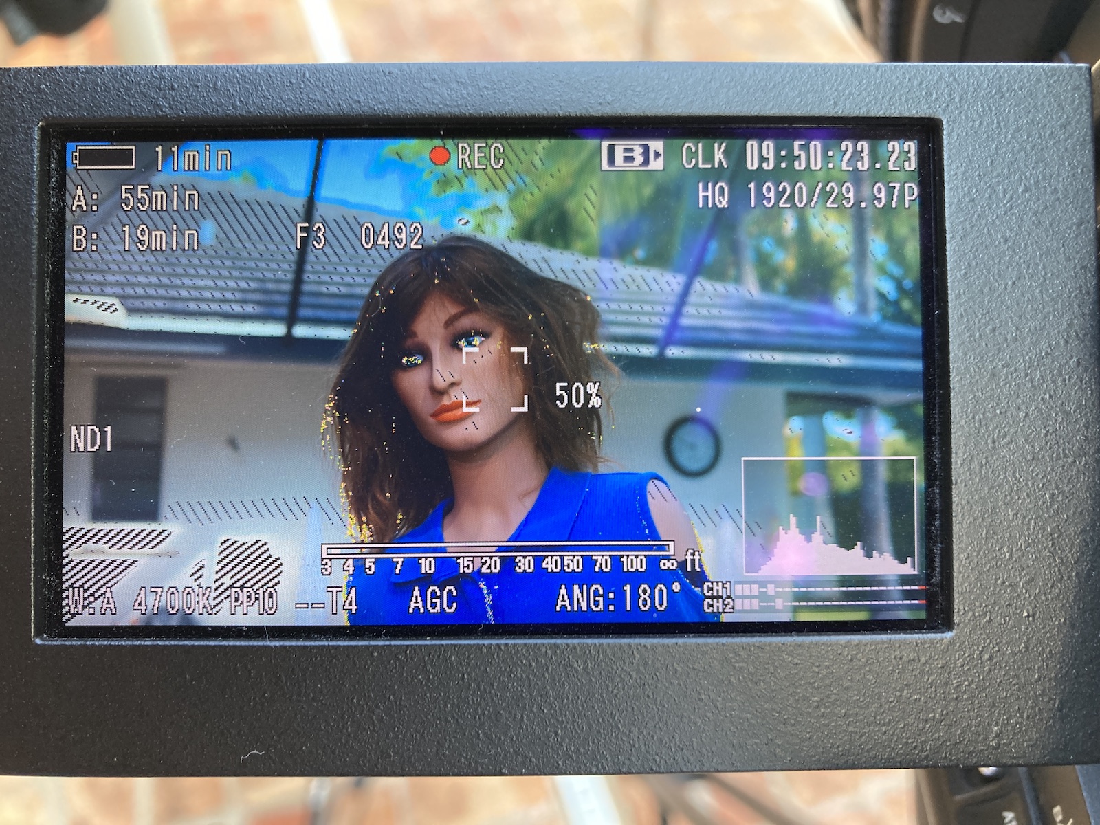

I know this is ancient history but there is scant information on TLCS for the PMW-F3. My pair of F3s have spent their life doing studio work but I recently started a series of man-on-the-street videos.
These are shot early in the morning to accommodate the tendency of the bright Florida sun to blow out the background. My twin Zylight Z90s barely raise the subject brightness.
But because I am doing the interview, I don't have an operator to ride the iris as the sun brightens. I found that the 30 minute difference between setup and finishing the interview is noticeable. So I'm looking at TLCS/AGC to adjust the gain down to compensate during the morning sun rising.
Anybody know how the F3 AGC evaluates brightness? Is it the whole frame or just the Brightness-level Display indicator in the center?
