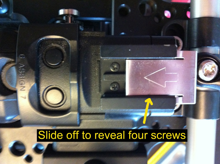

Has anyone done this, or knows of a method of doing this? This annoying VF appendage gets in the way more often than not and I would love to just remove it since I've only looked into it once on the first power up and determined it's visual uselessness. I know there are wires in there so I haven't touched it - yet.

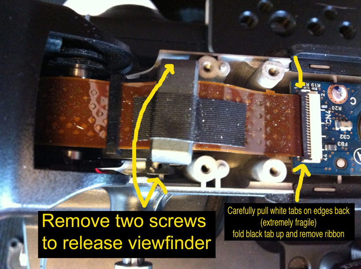

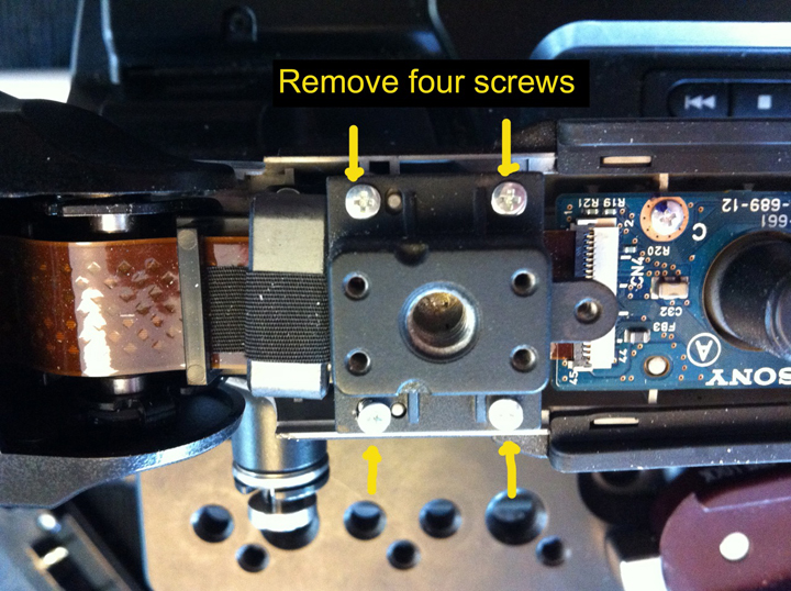

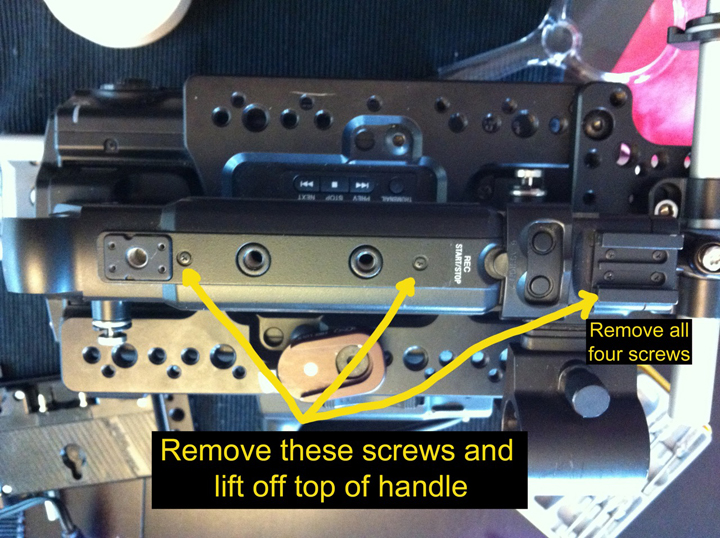

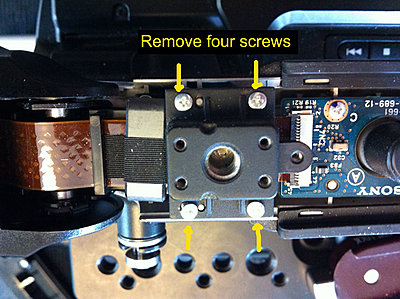

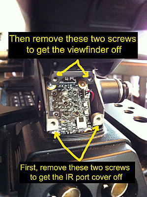

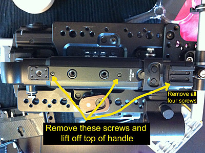

Yes, I've removed mine. I couldn't stand it anymore either. I'll post some pictures below so you can see what's inside the handle and how I got mine off, but please, do this at your own risk. There is a very fragile ribbon connector inside the handle which attaches the viewfinder to the camera. I'm not entirely certain I'll be able to get mine working again, but I don't much care. I agree with you that it's useless.
Removing the F3 rear VF-f3-viewfinder-1.jpg   Removing the F3 rear VF-f3-viewfinder-2.jpg
Removing the F3 rear VF-f3-viewfinder-3.jpg   Removing the F3 rear VF-f3-viewfinder-4.jpg

Nice pics Kirk. I'll have a go at it based on your process.
Thanks.

Are you able to retain the remote IR receiver after the VF circumcision? It's unclear in the photos...

Yes, you retain the IR. You just need to temporarily remove the plastic cover.
