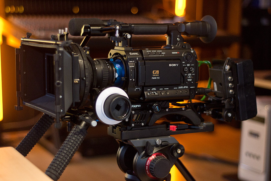

Everybody Stop right there. I found the solution: The Tilta Baseplate BS-T03 It cost me about 400 bucks and its the perfect solution. I switch to shoulder, to steadycam, to crane in no time, and the weight is always in the center, where its supposed to be. All thats missing now is a Z-Finder EVF with D-Tap.

It's neat, but doesn't it make the lens height very high when on the shoulder?

Were you able to get two screws into the base of the camera?

That's an impressive design for the money. The two things I would say that despite the three or four inches of fore-aft travel that was included, the weight will only stay centered if one's lenses are all roughly the same weight, otherwise the CG will migrate forward with a heavy lens beyond the system's capability to counter-balance. The rod holders front and back look to allow little to no ability to slide into the base, meaning that when lens swaps occur from short primes to long zooms, this will require swapping out the rods as well which is a much lengthier rebuild.
That may not be a problem for some, perhaps many users. I know that I prefer the ability to adjust the length of the rods over a good 8" or more to avoid rod swaps, and I don't feel that a cutout is necessary for good handheld operation, just a flat base that allows me to slide the camera fore and aft on the shoulder to find the exact CG (using either a strap-on shoulder pad, or a velcroed one that can be instantly moved to the sweet spot).
