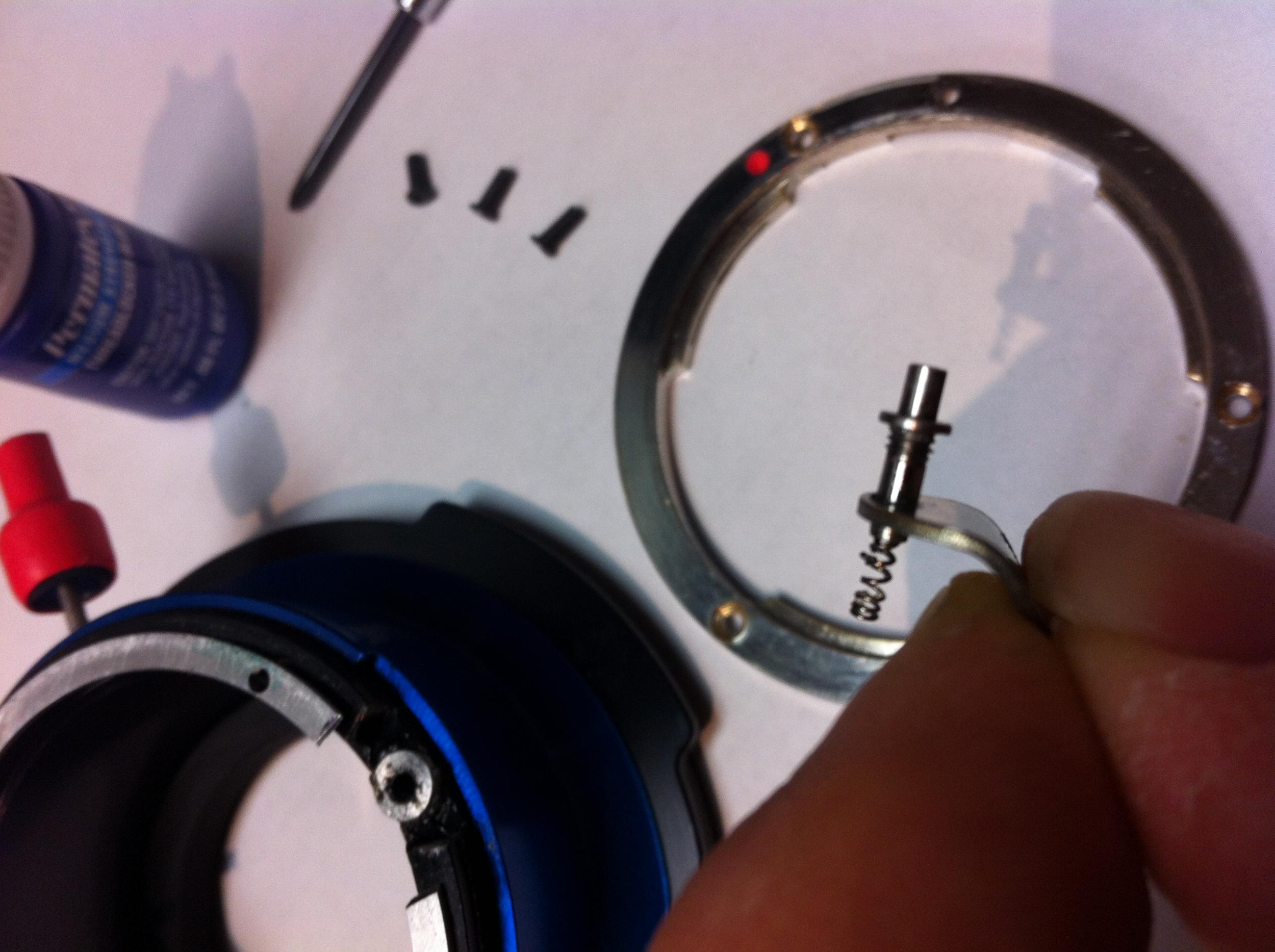

Old November 21st, 2011, 07:40 AM   #6
Location: Boston, MA
Posts: 321
Re: Problems with MTF adaptor
Disassembly photo showing thread on the pin
Thanks for that, Steve. I hope that MTF owners will take note.
