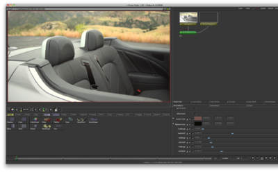

I took a stab at it just to see what it would look like. Spent about 3 minutes on it. Used a color replace node in Shake. Didn't look too bad really. Would definitely need some fine tuning to look real though.
F3 Nissan Spot - Discolored Seat Belts (IR Issue?)-seat-belt-color-replace.png
Aaron, doesn't look bad but you can definitively tell how the color is falling apart. I think this will be more apparent during a moving shot as well.
I tried a 'color replace' in After Effects and it was pretty bad. Maybe After Effects isn't the best place to do this? Post was planning on using AE and Magic Bullet for color correction. Wish we could go to a third party with a Resolve, but not sure the agency has that budgeted for this project.
I'd love to post a rough cut for you guys to watch but I think that may get me in trouble. ;)
Philipp Eierund is offline   Reply With Quote

And if you are using a program like Apple Color or Blackmagic (Davinci) Resolve doing an object color change is quite easy to do. Take a few seconds once you know how to do it.
I was avoiding coming in here and spouting how trivial a fix it is in a good color correction program, but it's pretty dang easy.
Sooting it right in the first place is step 1, but when it's already done, it's not a big deal if the job is already getting a color pass.
I actually spent a little more time on it after I took the screen shot. I used the picker to select the seat color as the replacement color. It looked much better and seriously looked passable. Wouldn't matter if it were a moving shot, the color is fairly well isolated and I've also masked the color replacement to only apply to the belts. Just animate the mask shape/location and it could follow the move of the shot easily.
But yes, you guys are all correct,... much easier to get it right in the camera before it's recorded.
Aaron Newsome is offline   Reply With Quote

quite right on the isolation ... imagine a presentation where the rostrum is wood red/brown and a moving speaker in black (showing far red contamination) under tungsten with a strong red signal ... nightmare!
I've had to do this and I don't ever want to have to do this again. Getting it right with something like a tiffen IR T1 filter is a better proposition.
Shooting it right in the first place is step 1, but when it's already done, it's not a big deal if the job is already getting a color pass.
I totally agree and have fixed this within AE but I can't recall exactly how I did it. I will try to find it or duplicate it and let you know.
Since your people have AE, they also have Mocha which will track the shapes perfectly if you need masking.
