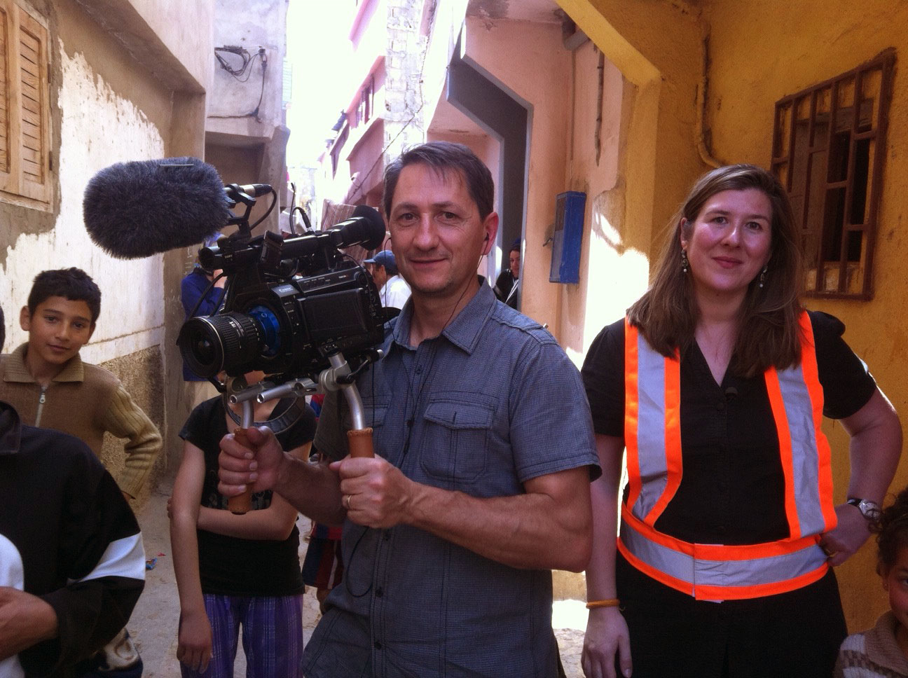

I use a Rycote softie so, unless I am in a very strong wind, no need to use the low-cut filter. I keep the audio input TRIM level to its default but since I run this mic on CH2 half of the time in AGC mode, I set the AGC level to LOW. A note about the AT875, it does not have a tight pattern so, not the best mic to use for on the fly interviews in noisy environment. I use a K-Tek K-CAM-SSM shockmount, very, very good and sturdy. Attached is a pic of my rig in action in Morocco to give you an idea.

Nice pic Thierry,
I want to go to Morocco too. Is the default -47?
I would like to avoid a shockmount if I can get away with the Sony Mic holder - just because I already have a TVLogic 5.6 in the hot shoe, also it won't fit in the camera bag without being taken off every time . Not too big a deal though and I guess I could mount both. Also I wonder if there is a smaller Rycoat for that mic looks pretty big.

The K-Tek shock mount is very quick to release, two seconds, literallly. Yes, that wind sock is a bit bulky, looks even bigger on the pic because of the side lens. The 875 comes with a foam sock that is much smaller. Stay away from using the F3 mic holder, it is a bit flimsy and not good for any mic that is heavier than the stock mic.
You shoudl look at Schoeps for a lighter mic option but it won't come cheap...

Damn Thierry,
You just look like a filmmaker!
