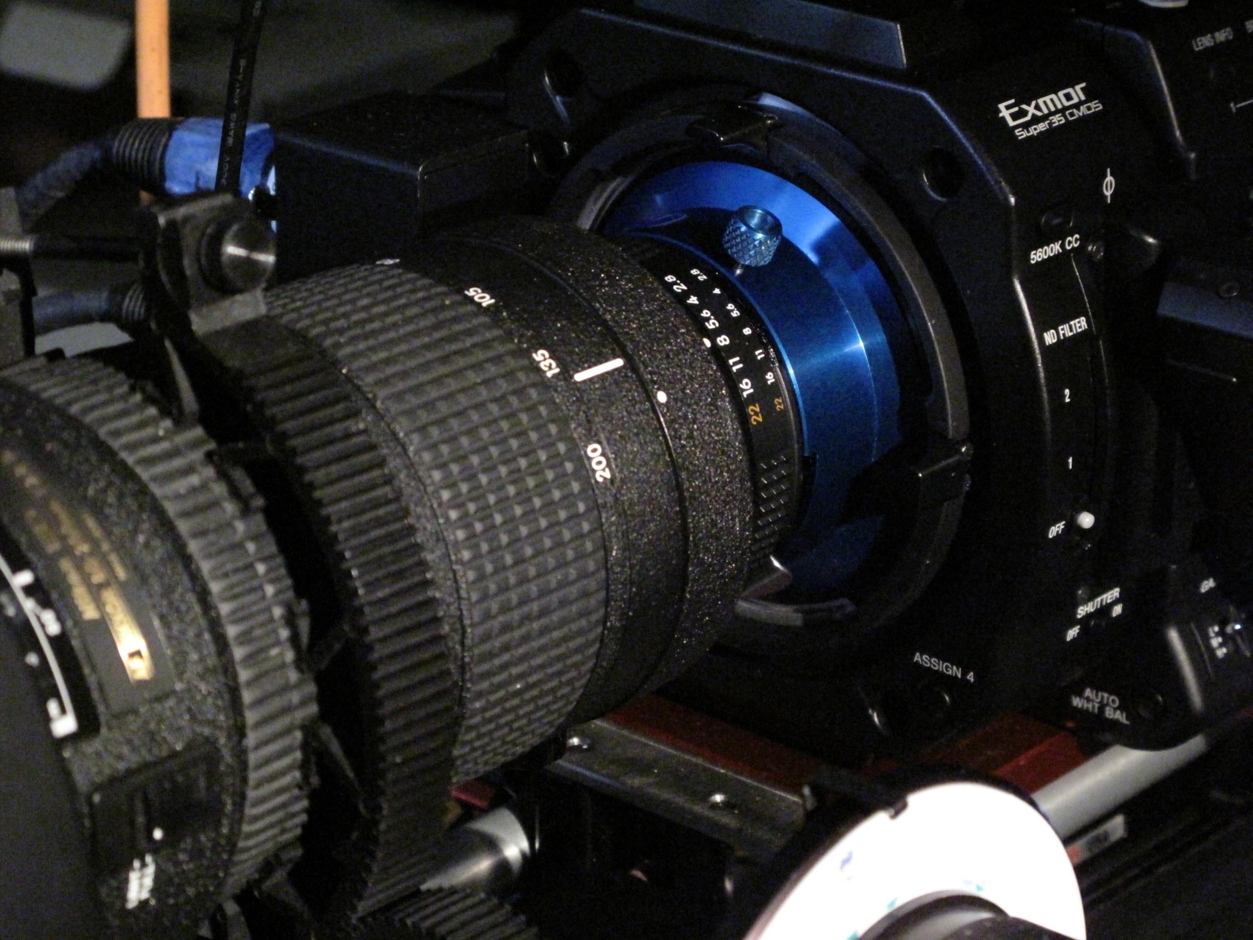

I like Thierry use the Nikon 80-200 2.8 when a client is in need of varied FOV's, but I prefer the ZEISS ZF 85 F1.4, or the 50mm. My 50 is the macro type which is a slower F2.

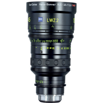

My ideal zoom would be. But 29K
Lets start a fund to help me buy this lens. 'Premiere' level of donations start at $1000 and get you pictures of the lens on a F3 :)
