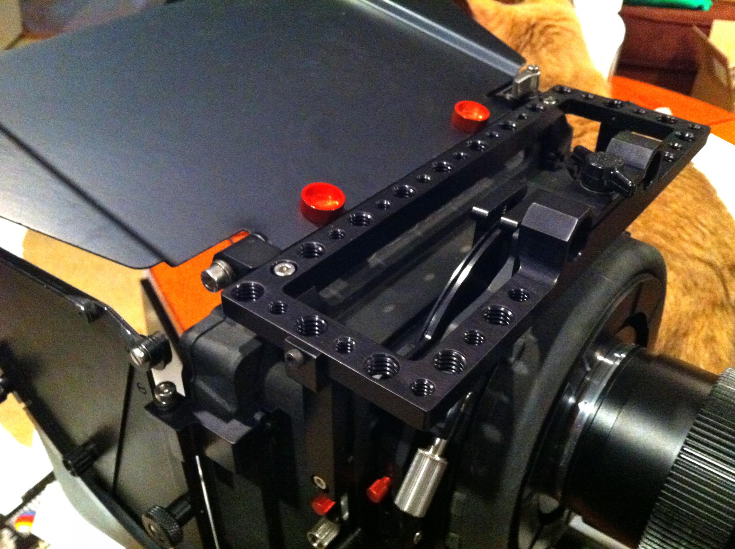

Yes it does--it becomes a mounting point for accessories at the front of the camera assembly. Which I've taken to a further level than O'Connor themselves--see attached photo. However, the infuriating part of the design is that not only does it require a hex wrench to attach and remove the O-grips, it's a finicky process that requires explaining and demonstration to each and any assistant that works with it. I've just resigned myself to using the supplied rod mount bar for the O-grips instead of attaching directly to the O-box.
If you are wondering the point of having top rods as well as bottom rod attachment points--more to come as I'm having more parts machined as we speak. But you can also see that rather than wait for O'Connor to come out with side flaps I've had my parts made to use my Chrosziel siders with the O-Box.

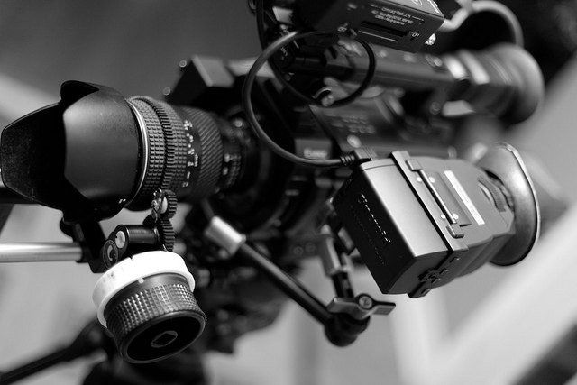

I have that Chrosziel. You have to buy a separate gear that reverses it and sitson top of that gear. Just saw the new Petroff that has the reversing system built into it. I got my Chrosziel 4 years ago and its been solid. I like these new systems with it built into it so you can use it also with Cine lens. Its a bit of work to take the revering gear off, so I have a second follow focus for Cine lenses and EFP lenses.
You can see the second gear in the attached photo. Also as we talked about it only can go on one side of the follow focus, so its been a problem with my new Chrosziel Matte box. I have to leave my hood on my 24-70 Tokina so there's enough space between the lens Matte box and follow focus
