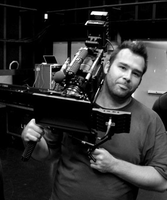

That's sage advice. I'll add a little I learned from shooting 2.5 years with the Red:
It didn't take long to learn after I bought the Red that the only way to do handheld was to mount the 5" LCD right next to the mattebox. The camera would balance on my shoulder and the LCD filled maybe 60-70% of my field of view, allowing some peripheral vision to navigate while doing handheld tracking shots.
After I got the Red EVF, I realized that it had to be so far forward that it blocked access to the lens for the assistant (and me, too). And it added a noticeable amount of weight to an already heavy rig. I used it once for handheld, once was enough.
Also, if you get a Cineroid or Zacuto EVF, resist the urge to mount it with a noga arm. When you go handheld with it, the mass of the camera pressing the EVF against your eye will loosen the EVF after a few takes, and then the arm will either loosen from it's 1/4" moorings, or the balls will give way, leaving your EVF in a place your eye can't get to it. Redrock, Zacuto and Cineroid love to show those finders on a noga arm because it looks so clever, but the reality is that when the mass of your body and a 20lb camera is involved, they'll never stay put. Figure out something else...
[edit: attached a pic of what I'm talking about on the Red. Looks weird, but the day that pic was taken, I had done 6 hours handheld with that cam]
Instead of re-inventing the wheel, consider the solutions that have been in place for years to manage larger rigs.
Yes, keep in mind guys who operate 35 have been dealing with this stuff for years. The 'rigs' I see on retailers and manufacturers web pages often go from questionable to ridiculous in actual usability, based on my experience. Please remember those guys are there to sell you little aluminum doo-dads, not solve your problem in the cheapest/most efficient way possible. I'd recommend googling pictures of 35 handheld rigs, because chances are those are the guys that have to do it for 12 hour days and you can reverse engineer from the pics what works.
My Work: nateweaver.net
Nate Weaver is offline   Reply
