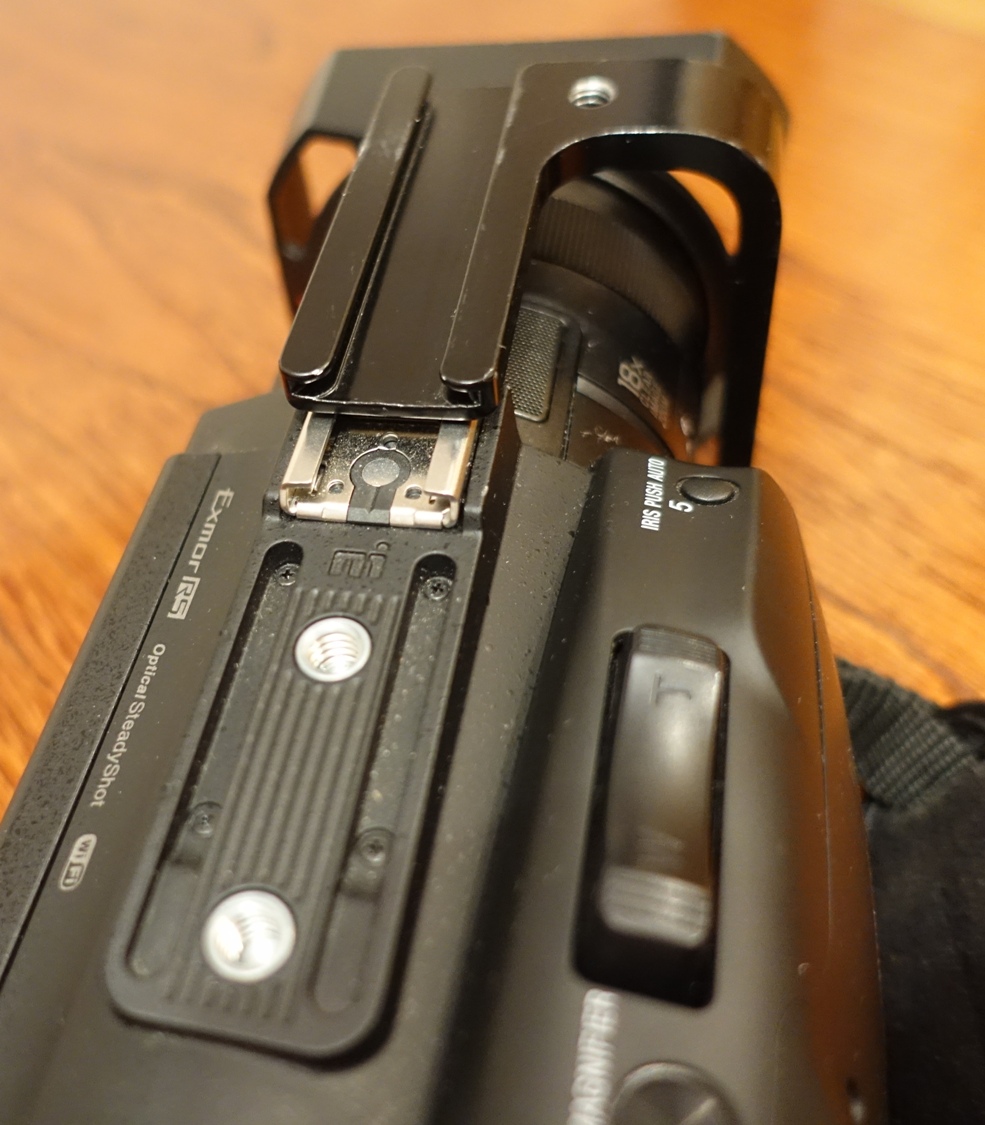

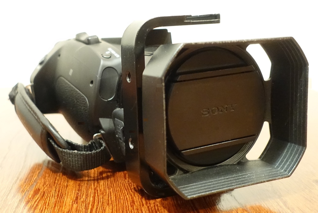

I've used the wrap around mount on my FDR-AX100 to support heavy accessories. The camera gets top-heavy, but it's a good solution when you want to keep the overall bulk down. I have the Z90 sitting here and it looks like the mount would work with it.

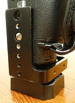

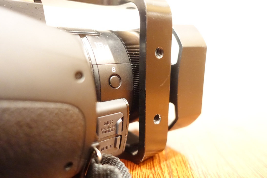

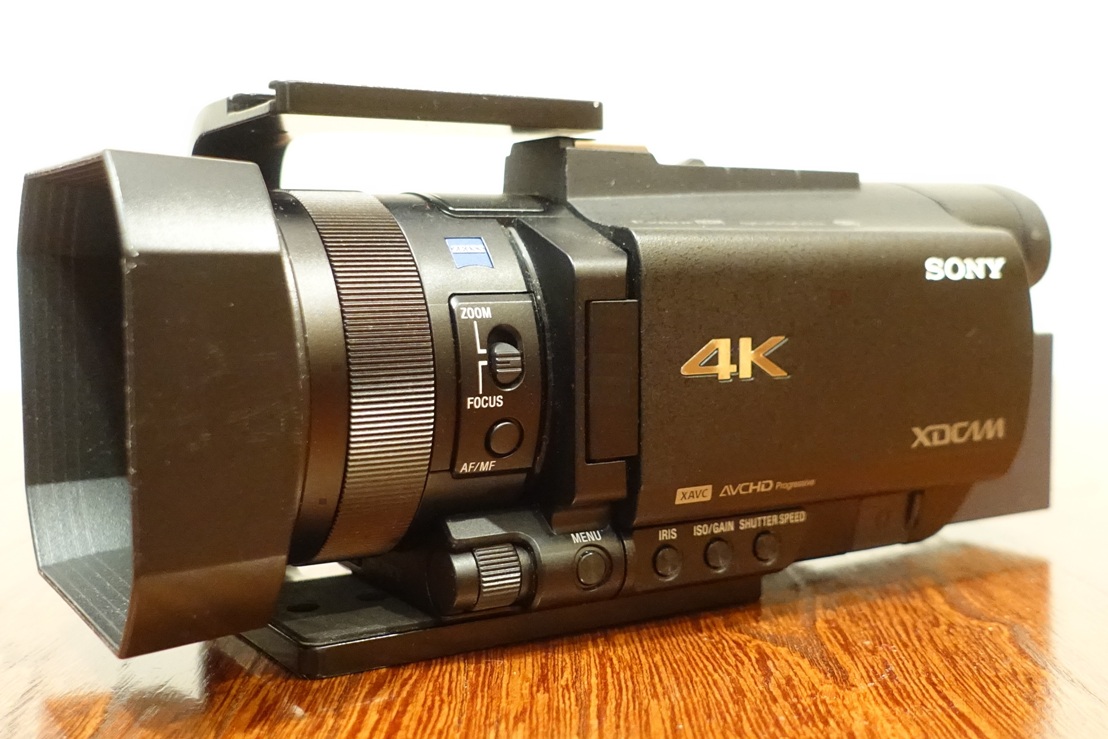

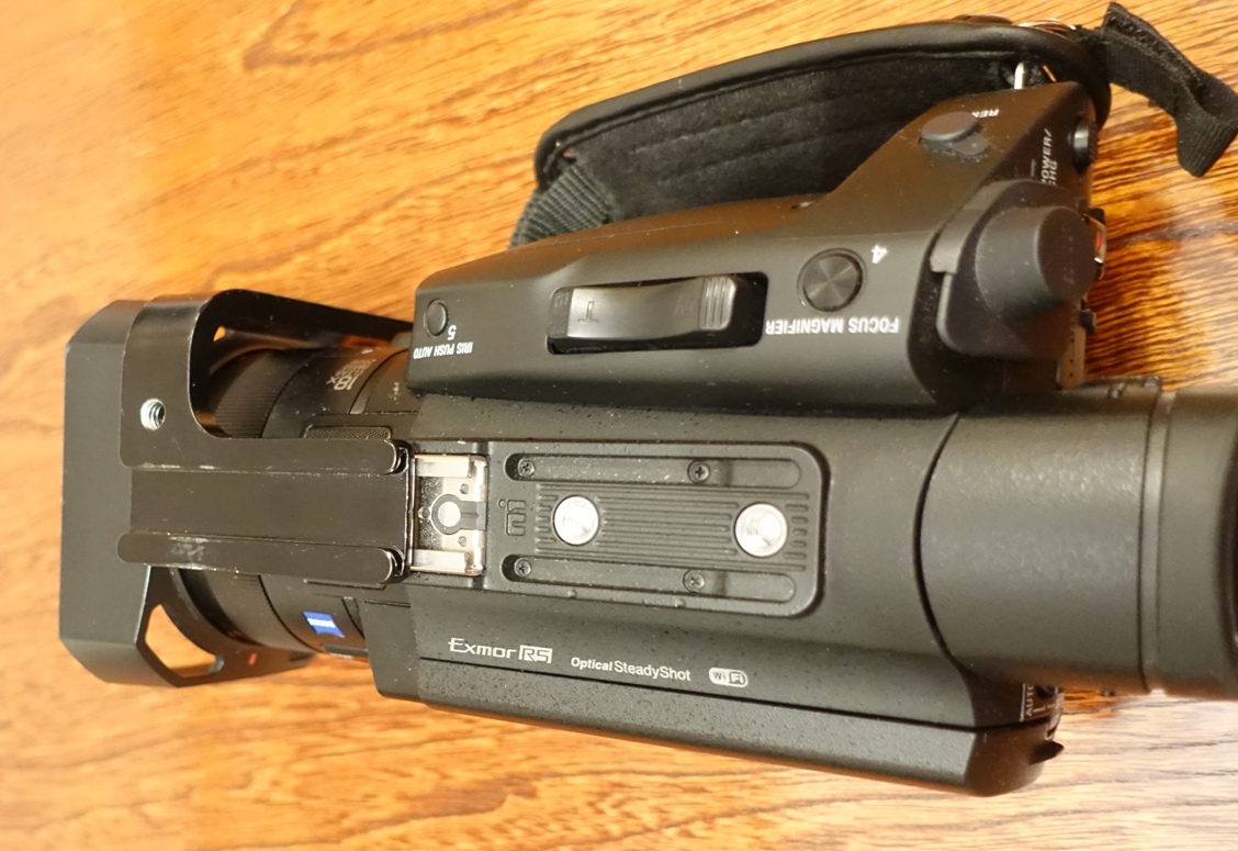

It wraps around the lens barrel forward of the handle. I just put it on and it will fit. I don't see any place it would interfere with how I hold or operate the camera. Enough of the focus ring is available on the left side for me to use it.

Am I missing something? There is no way in hell that bracket can be used with a Z90 unless you take the handle off, and then you have basically ruined the camera if you care about audio. You must be talking about the grip instead of the handle, right?

Yes, I meant the grip. I've been using an external recorder for audio.
