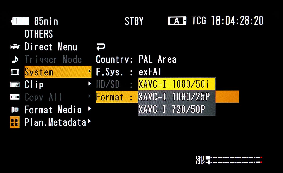

Formatted a 64GB SxS1 card to Fat32 mode in the camera. XAVC format options then become available (but not in the UDF mode).
And the recording capacity of the card is now down to one hour.
Shot a very short test file in 25p and Media Player Classic's properties function gives the following results:

No idea about how it would work with the adapter as I don't have one. My guess would be that Sony would want to software lock this to the SxS cards only because of their reliability. Don't need to risk the possibility of wildcard 3rd party issues messing with the reputation of your future-of-the-industry codec platform.
Andrew
