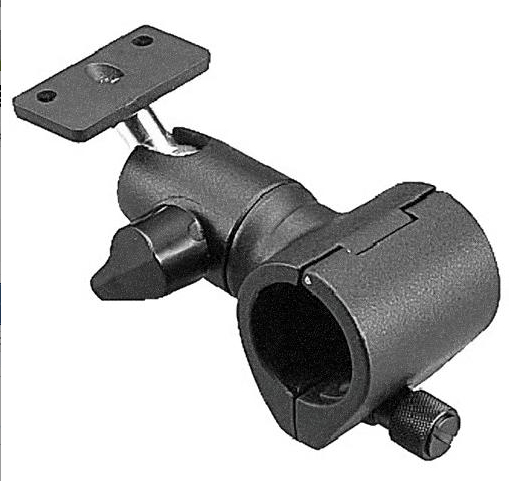

One more mic holder question... would this other, more expensive Sony mic holder (jpeg attached, I hope) allow me to fit my EX1 into my rather tight carrying cases (I use both a Portabrace bag and for more rugged shoots, a Kata backpack, and in each case, the 'lower' I can make the EX1, the better, i.e., I don't have a lot of headroom) a little more easily?
Looking at the photo on the B&H site, it seems to me that this mic holder (if I attach it upside down) might allow me to have my ext. mic sitting just next to my XLR inputs. This could make the overall configuration of my EX1 a bit wider, but not as tall. But I would want to make sure that I can leave my two XLR plugs (if that's the right word for them) plugged in. I hate disconnecting things (to fit my camera into a case), because this means reconnecting them, and I'm often in a hurry when shooting.

Hmmm. I definitely want to be able to keep my Sanken mic attached at all times. I've done it like this ever since I got my EX1, and this is the first time I've had a problem. So if I can't fix my broken mic holder properly, I'm going to get either the mic holder I included a picture of... if it would fit, and if it would make my EX1 a bit more compact, or I'll get the Sony replacement.
If I do the latter, I just want to make sure that the one Sony sells for the EX3 would fit the screw holes in my EX1. Are there any EX1/EX3 owners out there who can tell me if the mic holders are the same thing for both cameras?
