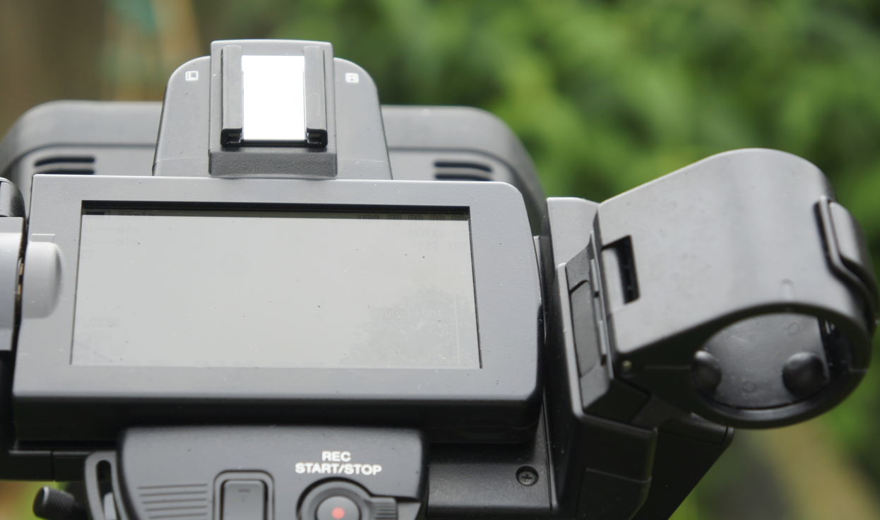

The front shoe is the best place for receivers. Those of us who use the EX1 heavily as a handheld know that moving things off center interferes with the shotgun on the right and line of site on the left. It also makes them wobbly when moving around. Sticking them fully forward also makes them wobbly and potentially put's the antenna into frame.... especially with a WA adapter. It's a hack and I'd rather a properly designed shoe/LCD subsystem. Being able to view the LCD from the right side is a tripod thing and the PMW-200 design forfeits a good design for the shoe for what? Being able to view the screen from the right (albeit at a 90 degree angle which is somewhat of a joke) is a tripod scenario easily handled with an external monitor. I can't imagine Sony hearing otherwise if they'd gotten input from non-broadcast users.
Below is the PMW-200 design from the review at xdcam-user and the Sony's own UWP wireless in action on an EX1 during the filming of a piece by Thierry Humeau which would most certainly be in the way in the PMW-200 design.
Sony PMW-200 Brings HD 4:2:2 Workflow to XDCAM Camcorder Line-pmw-200-shoe.png   Sony PMW-200 Brings HD 4:2:2 Workflow to XDCAM Camcorder Line-ex1-shoe.png

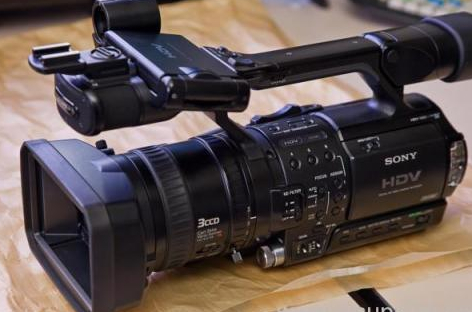

I feel your pain Les but a simple solution would be a $20 extension bar::
http://www.bhphotovideo.com/c/product/407098-REG/Rycote_037303_037303_Hot_Shoe_Extension.html
Sony could have very very easily implemented the same design as the Z1's hot shoe. But for 50 422 I don't really care :)
Sony PMW-200 Brings HD 4:2:2 Workflow to XDCAM Camcorder Line-z1.jpg
