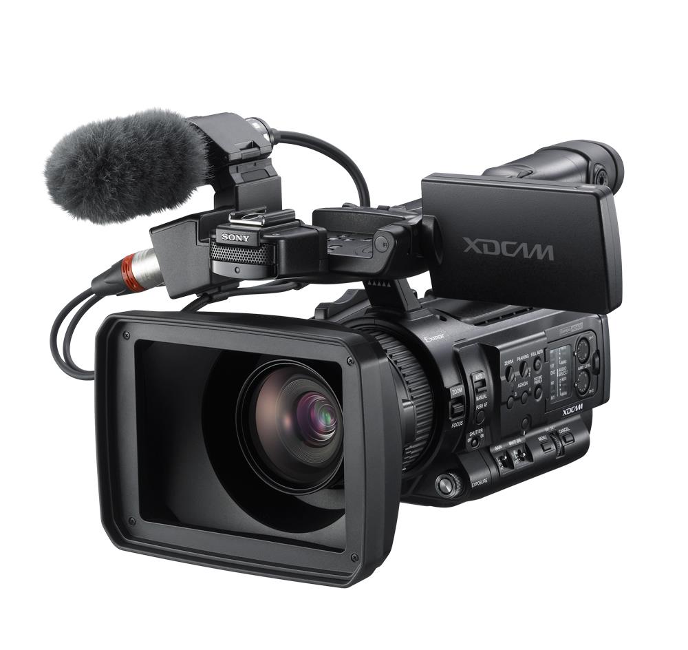

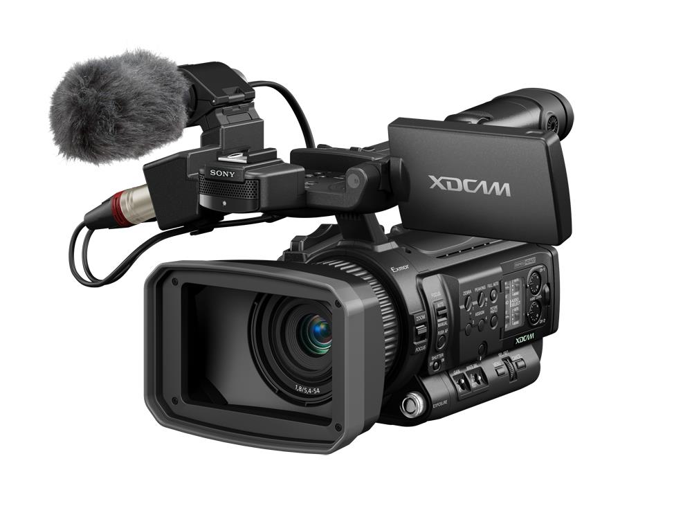

Looks like it uses the same VCL-HG0737K .7X wide angle lens designed for the HD1000U.
New Sony XDCAM - the PMW-100-pmw-100.jpg   New Sony XDCAM - the PMW-100-pmw-100-wideangle.jpg
