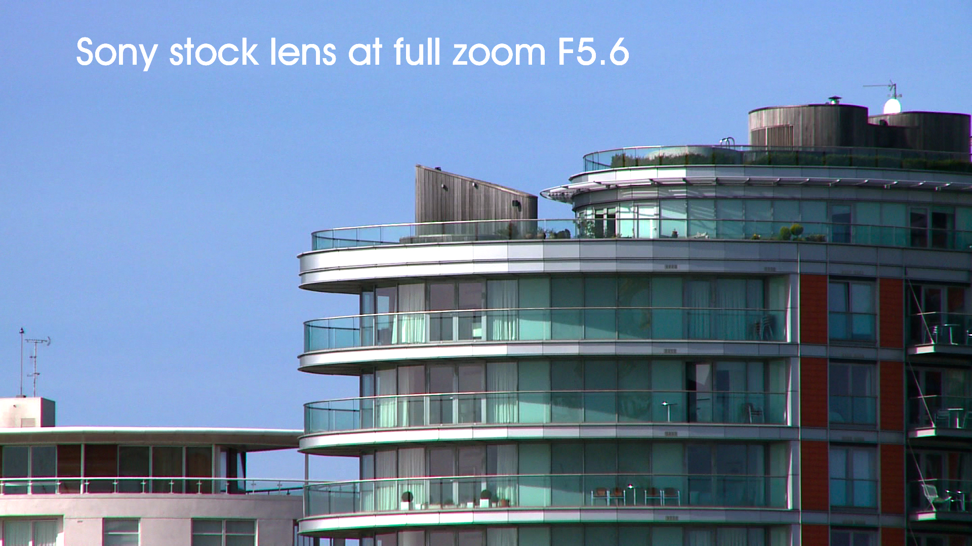

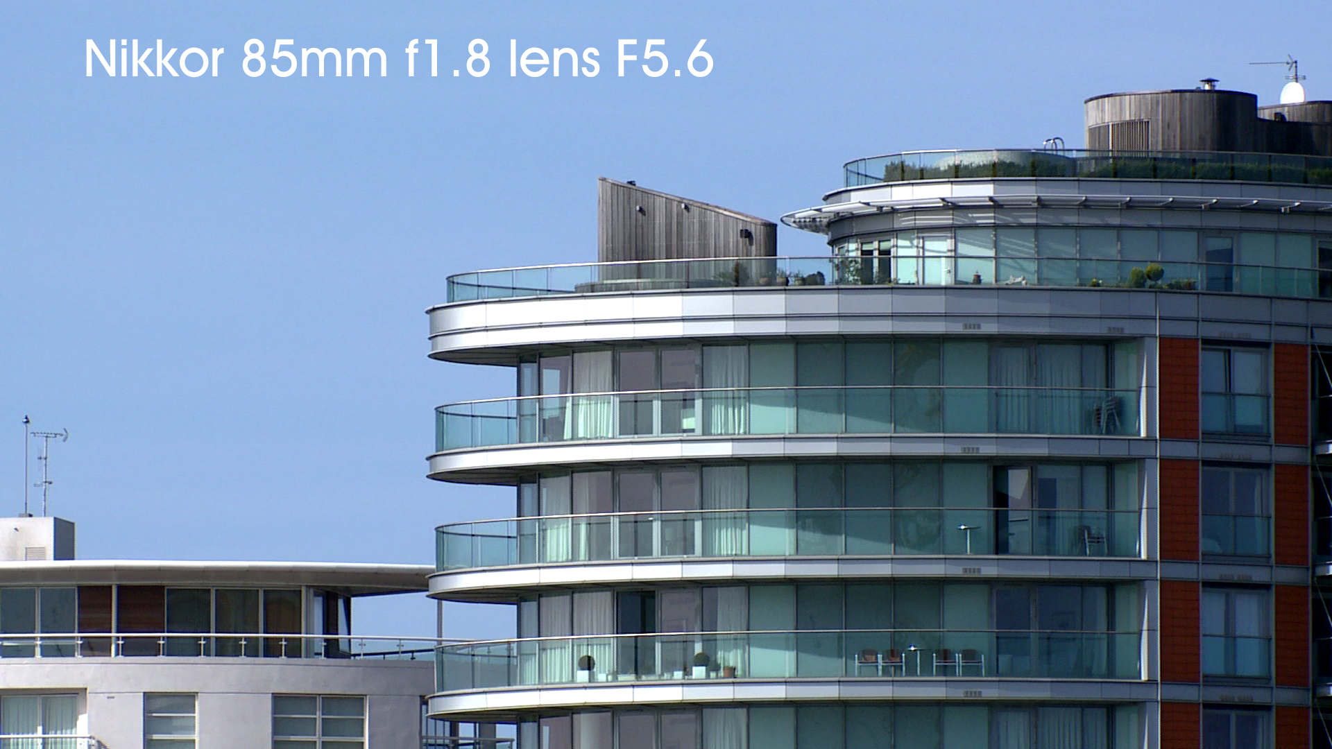

There is realy no substitute for a good quality lens. Here are two examples. One was shot at the full zoom setting on the Sony stock lens, the other was shot with a 85mm Nikkor using Steve Schovlars Adaptimax adaptor. Look at the left edge of the pictures. Click on the images below to open them, then click on the image again to view at 1:1 magnification. The difference speeaks for itself.
Chromatic Aberations on EX3 question-sony1.jpg   Chromatic Aberations on EX3 question-sony1_85nikkor.jpg

The differences between Nikon and Fujinon are impressive. I would be very interested to know if the lens file for the Fujinon is set to its optimum. The menu provides for adjustment capabilities but so far I have not seen an account of the best way or even any way to effect the procedure. Even the local Sony repair centre cannot offer assistance.

I haven't touched any of the lens file settings other that doing an Automatic Back Focus from time to time.
The Nikon lens used is the old style manual Nikkor, i.e. not the rubberized grip type. I have a whole set of Nikkor lenses ranging from 20mm through to 500mm, you can pick these lenses up for a song on e-bay or other sites as most people want auto focus and up to date lenses. Optically they are still superb lenses as you can see in my sample.
The stock lens at full magnification is roughly equivalent to the Nikkor 85mm.
