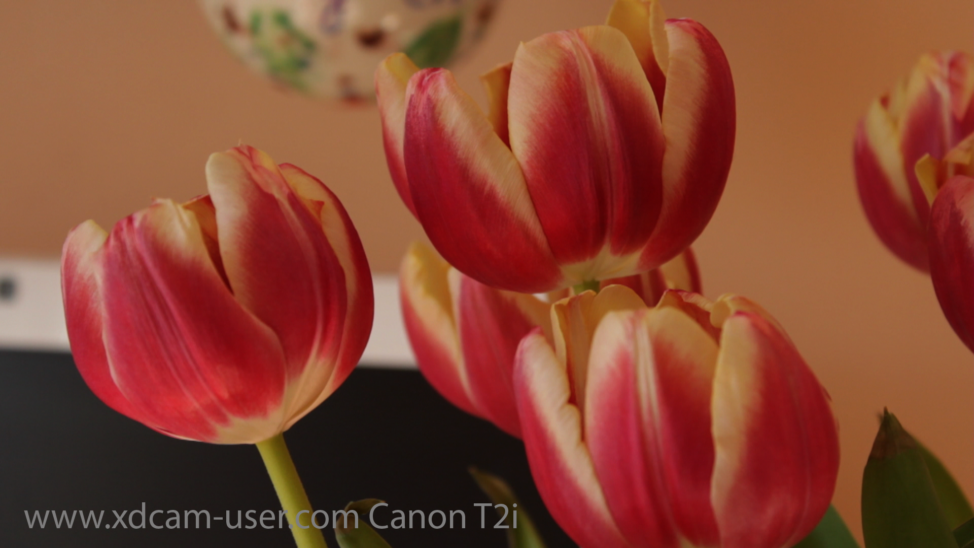

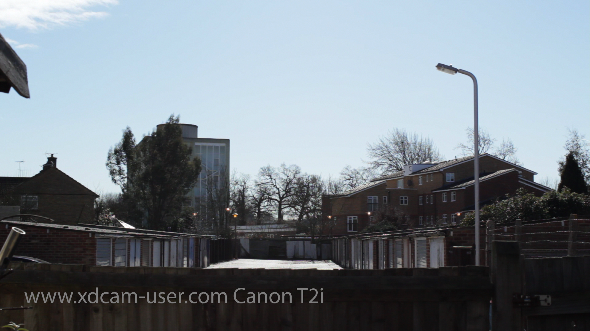

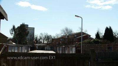

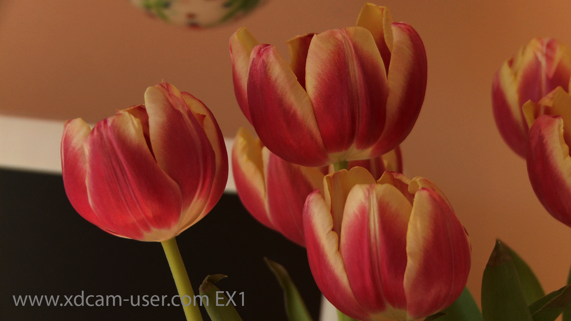

Below are some frame grabs from an EX and a Canon 550D/T2i. the difference is pretty clear.
EX1 vs. EX1R sharpness test-canon-flowers.bmp   EX1 vs. EX1R sharpness test-ex-flowers.bmp
EX1 vs. EX1R sharpness test-canon-wide.bmp   EX1 vs. EX1R sharpness test-ex1-wide.bmp

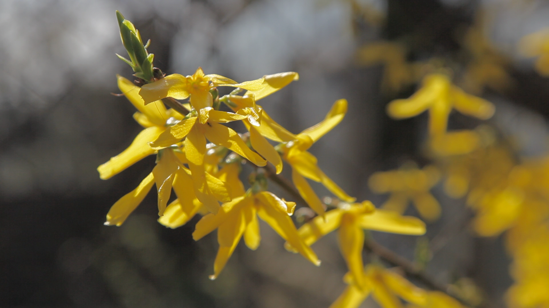

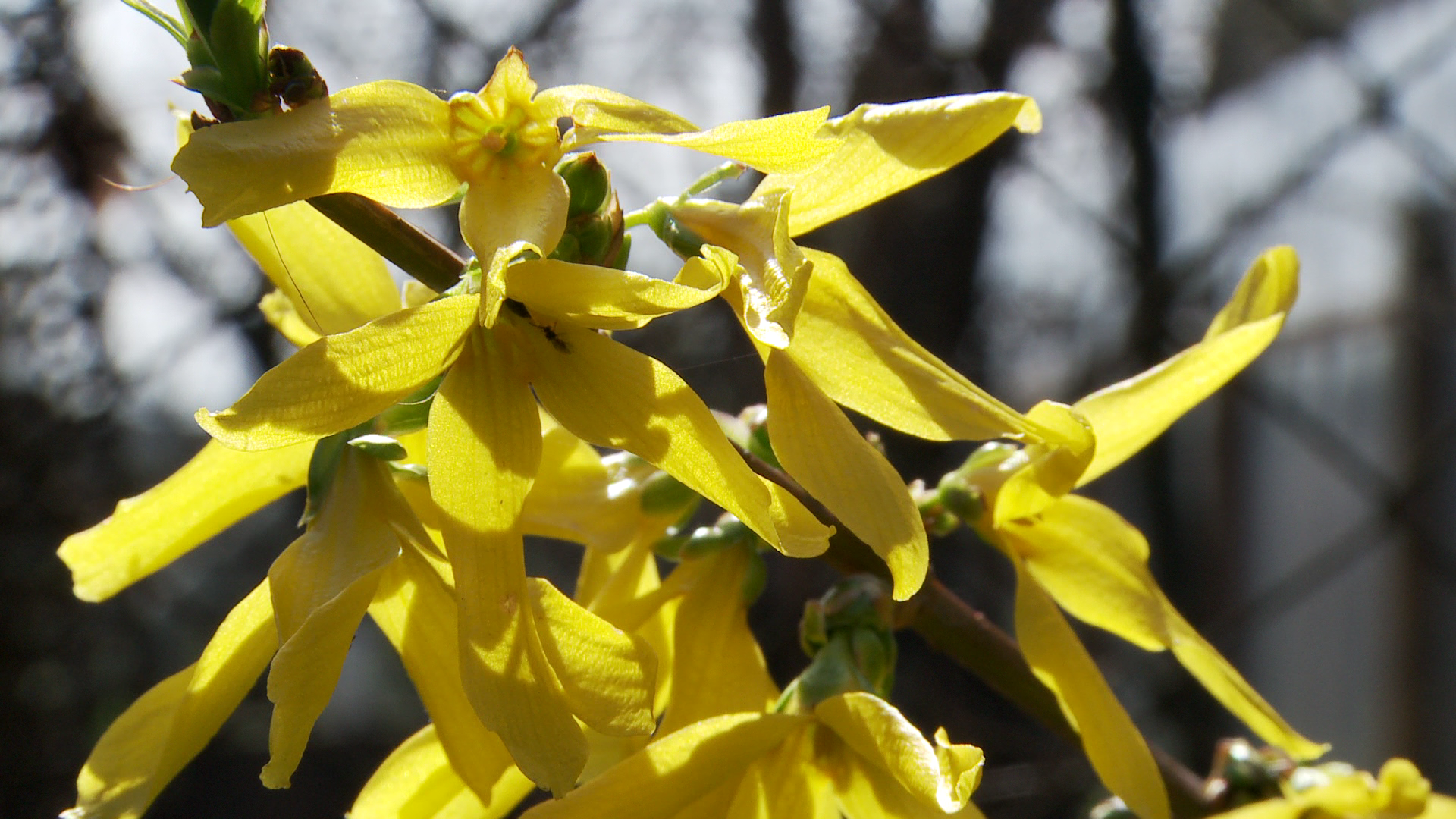

Ex1R has a very good idea, we used identical diaphragm 8 and 1 / 100 exposure
EX1 vs. EX1R sharpness test-canon-01.bmp   EX1 vs. EX1R sharpness test-ex1r-01.bmp

The Canon DSLRs don't have an effective anti alias filter and the way the sensor is read means that the image is seriously under sampled, as a result the pictures are full of alias artifacts which can be mistaken for detail. For example, what should be a smooth edge may appear to be a very sharp, instant light to dark edge as the sensor sampling isn't high enough to resolve the smoothness of the edge. This isn't real detail, it's fake detail. It can look OK, but any camera movement will make the edge flicker as it jumps from one pixel to the next and straight lines take on a stair stepped appearance. This is aliasing and most cameras normally have a filter to soften the image a little so that stair stepping etc doesn't occur (that's why an EX only resolves 1000 TVL despite having 1920 sensors). The best way to see the difference in resolution between an EX and Canon DSLR (other than a chart) is to look at how they both handle subtle textures and things like wide shots of grass or foliage. In the frame grabs I posted earlier look at difference between the texture of the in focus flower blooms, it's a night and day difference. The other thing to take into account is contrast, a high contrast image will appear to be sharper than a low contrast image, so unless exposure and contrast are the same making a subjective assessment is difficult.
Sharpness and resolution are too different things. The resolution is the amount of fine detail that can be resolved or seen. Sharpness is how quickly the image goes from light to dark or how pronounced edges are. You can increase the sharpness of an EX (by turning up the detail level) and create a very sharp image with high contrast edges but this will not increase the resolution of the image, all it does is make the small details more pronounced, perhaps un-naturally so. Taken to extremes it will introduce aliasing.
