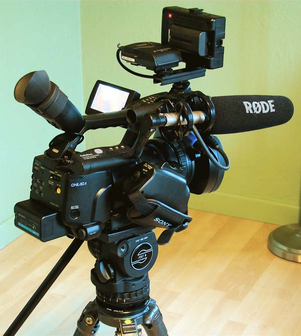

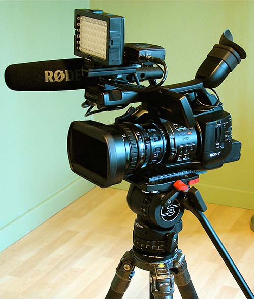

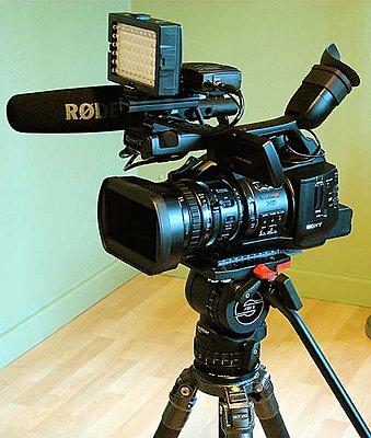

Perrone, I have the EX1 (nor R) and the shoe mount works just fine - not tight to push in at all. But I don't put my G3 directly in my camera's shoe mount anyway. I prefer to use one of these:
Rycote | 037303 Hot Shoe Extension | 037303 | B&H Photo Video
It will hold a light AND my wireless. Then I use a Rode SM5 placed in my camera's mic holder to support my microphones: Rode | SM5 - Shotgun Microphone Suspension | SM5 | B&H Photo
So I can comfortably fit 3 accessories on my camera. I'll try to attach a photo here:
How i can attach a wireless mic receiver to hot shoe?-ex1_rungun02.jpg   How i can attach a wireless mic receiver to hot shoe?-ex1_rungun04.jpg

I have G2 and G3. They both seem the same. Try turning the square thing that goes into the shoe mount 90 degrees. Or just loosen the round thing you screw down to secure the mount to the shoe.
It's only plastic anyway, so a little filing would be easy if it really needs it. I had to file down my Rode SM3 shockmount so it would work with an HV20 camera - and that was a PITA as it's metal. Anyway that hotshoe extension is awesome for the price and now I can fit all I need. They even have one twice the length for twice the price if you want to put a bunch of stuff on.

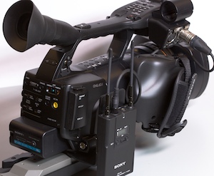

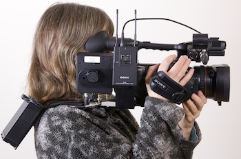

You can also use a system like mine where there is a wing for attaching wireless mics etc, without putting more stress on the somewhat under designed tripod mount on the EX1.
And it also has options for a shoulder mount system that balances the EX1 cams much better when off the sticks.
