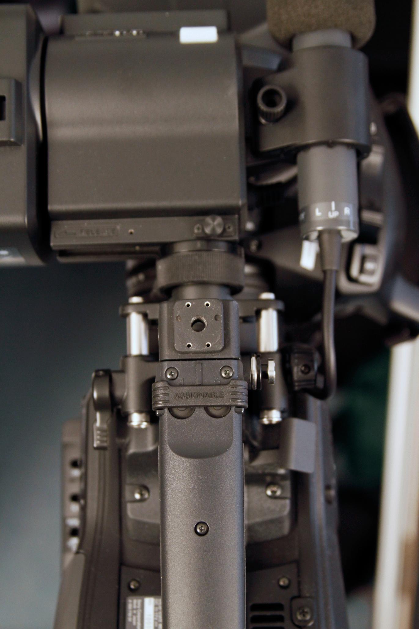

paul, i was wondering if the viewfinder on the 350 is adjustable like the one on the ex3... can it be moved to the left for left eye shooting or is it permanently fixed?

Yes Greg is moves left and right, forward and backwards and is very adjustable. Quick lever for fore and aft and locking wheel for side to side.
Here is top view where you can see the rails for forward/backwards and the channel for side to side. Sorry if it is a little out of focus I was focusing on the cold shoe.

great
thanks for the speedy response and the photo.
