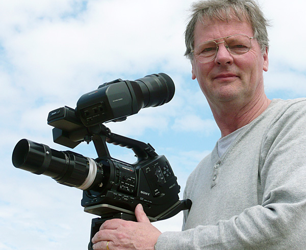

I have had my collection of Nikkor lenses (16 in all) for a number of years. I was tempted to part exchange the lot a few years back, but was offered such a poor price for them. Needless to say I turned it down and they have just sat in my office doing nothing, until I purchased the EX3. Now I have a great collection that have a second life.
Shown here is the 200mm f4 Nikkor lens with a haggard looking owner

Vincent, that 200mm f/4 looks a lot lighter than my 80-200 f/2.8
Being a prime, it's probably sharper, too.
I'm going to have to find one of those. Nice.

I'd go for a 180mm f2.8, it's beyond amazing optically!

I also have the same 80 - 200mm 2.8 Nikkor, and yes the 200mm f4 lens is a lot lighter, and sharper. Call me old fashioned or what, but the older series of Nikon lenses were built like tanks - they probably used the same metals too.
