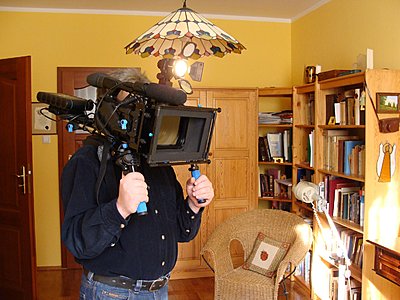

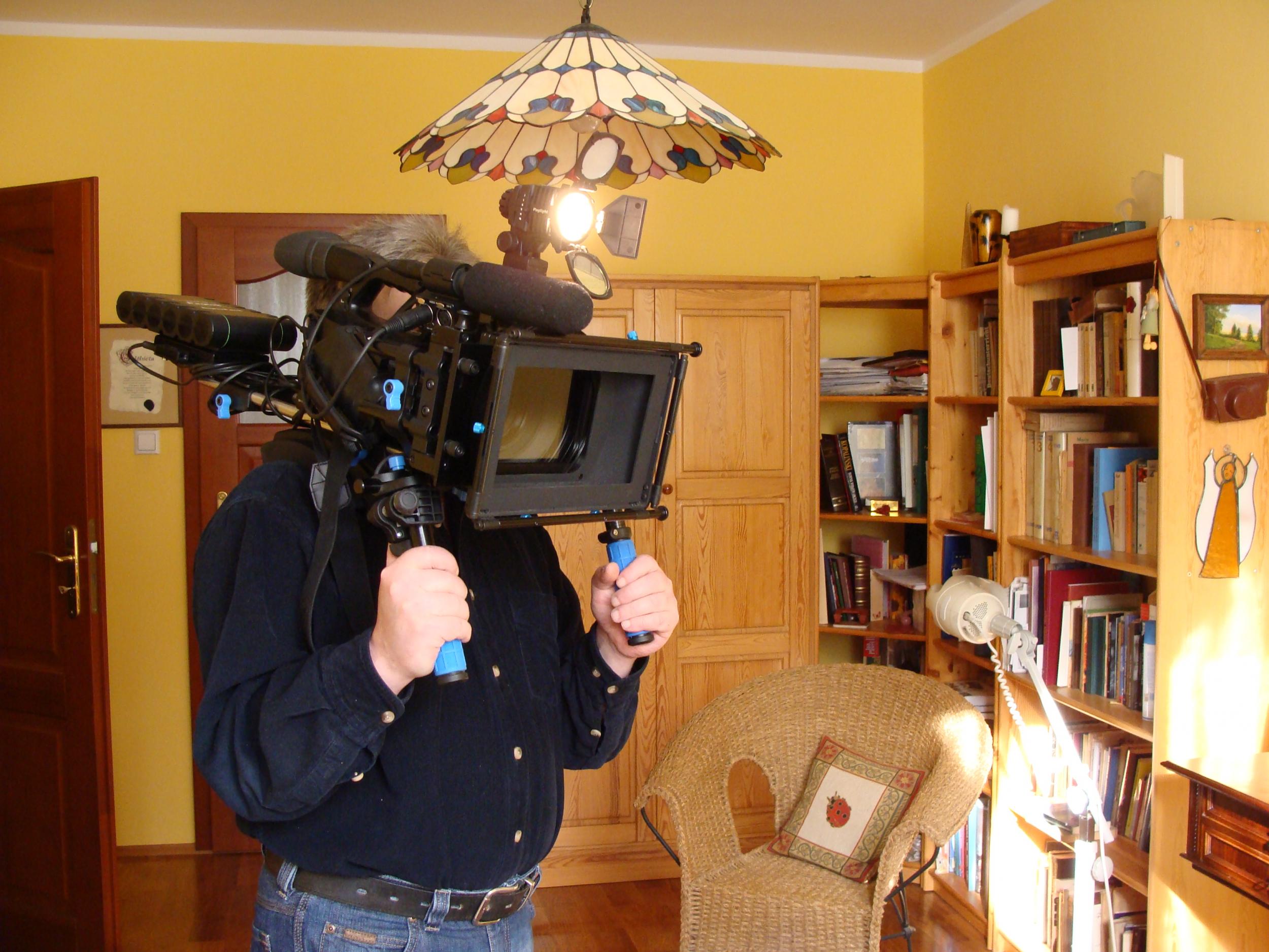

Originally Posted by Brett Sherman View Post
Can you post a picture with you and the Hoodman/RR combo? It would be much appreciated.
Brett Sherman

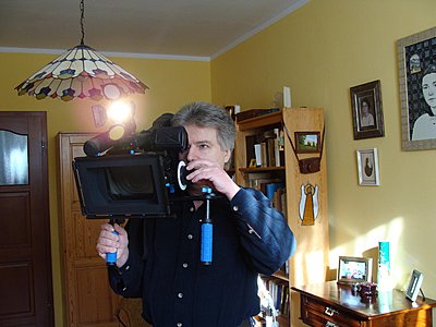

I realize I owe some more feedback to you, Brett, and perhaps many other reading this thread. Unfortunately, I'm in no position now to have photos taken of myself actually using the rig. Instead, I'll reiterate that:
- with the rig as depicted earlier in this thread, there is a QR plate between the RR shoulder mount pad and the camera. For me it's a must, as I often change configurations, putting the camera on the tripod with or without my Letus, then back again on the shoulder mount. However, this added height makes the use of Hoodman lupe just barely possible - certainly not optimal, and far from convenient.
- that said, if somebody is planning to put his EX1 on the RR shoulder mount more or less permanently, it's possible to fix it directly to the shoulder pad (using the typical screw and Allen key provided). In this configuration (I have just tried it so that I could take responsibility for what I'm posting here), using the Hoodman loupe is absolutely possible, as it becomes *almost* horizontal.
I hope this helps in making up your minds. I shall add however that if I could start all over again, I'd buy something more like Barry's Spider II, and possibly a smaller / lighter matte box for my shoulder-supported shooting. All my RR stuff is only perfect when used in the tripod configuration, which luckily is 90% of all my work.
Piotr

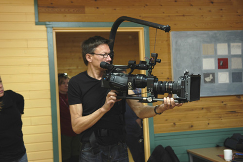

EasyRig Turtle
A couple of pages ago I suggested the EasyRig Turtle as a better option than shoulder mounts for the EXs. The benefits are obvious and well described on their website. The cheapest version is the Turtle, designed for small cameras, but the EX1 needs the Turtle X (strong). Yesterday at a rental place I tested the Turtle and decided against it. It works as described, nicely taking the weight of the camera so leaving your hands free. You can change from high shot to low shot without the restrictions that a lot of shoulder mounts impose. However I'm tall (182 cm) and the Turtle is designed specifically for the average person. To get the pole clearing my head the belt had to be about my waist (should be on hips) and while usable the fit was loose and wobbly. Did that matter? Strictly in terms of taking the weight of the camera it didn't, but as soon as I walked the pole wobbled and this affected the camera. Seemed to me that the EX1 with extras was stretching the capabilities of the Turtle and I would need the EasyRig 2.5 (firm fitting vest and adjustable pole). Unfortunately a lot more expensive, but will carry the sort of load represented by Piotr's rig (see photo from website). I'm a bit disappointed; lesson: as always, try before you buy.

Serena,
Many thanks for sharing your experience with us!
This is exactly what I thought when seeing the EasiRig webpage. BTW, their solution to avoid hanging a heavy rig by the camera handle is use the FigRig in between... This, plus EasyRig 2.5, would definitely be too expensive and bulky for me!
Brett Sherman
Brett, here are some pictures you requested.
Best shoulder mount have used for ex1/3-dsc01460.jpg   Best shoulder mount have used for ex1/3-dsc01457.jpg
Wow! Piotr - "That'salottagear!!" - how much does everything weigh including the shoulder mount as you have it configured in the pictures?
