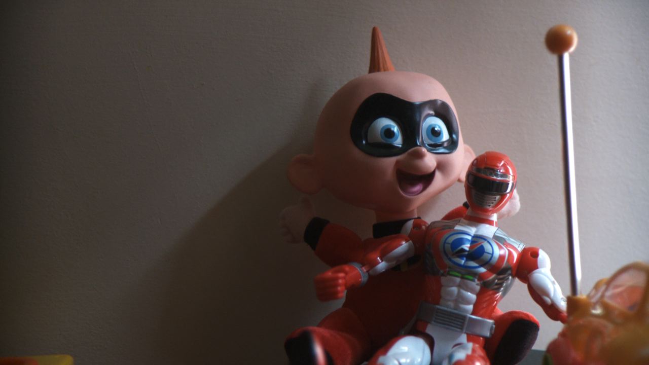

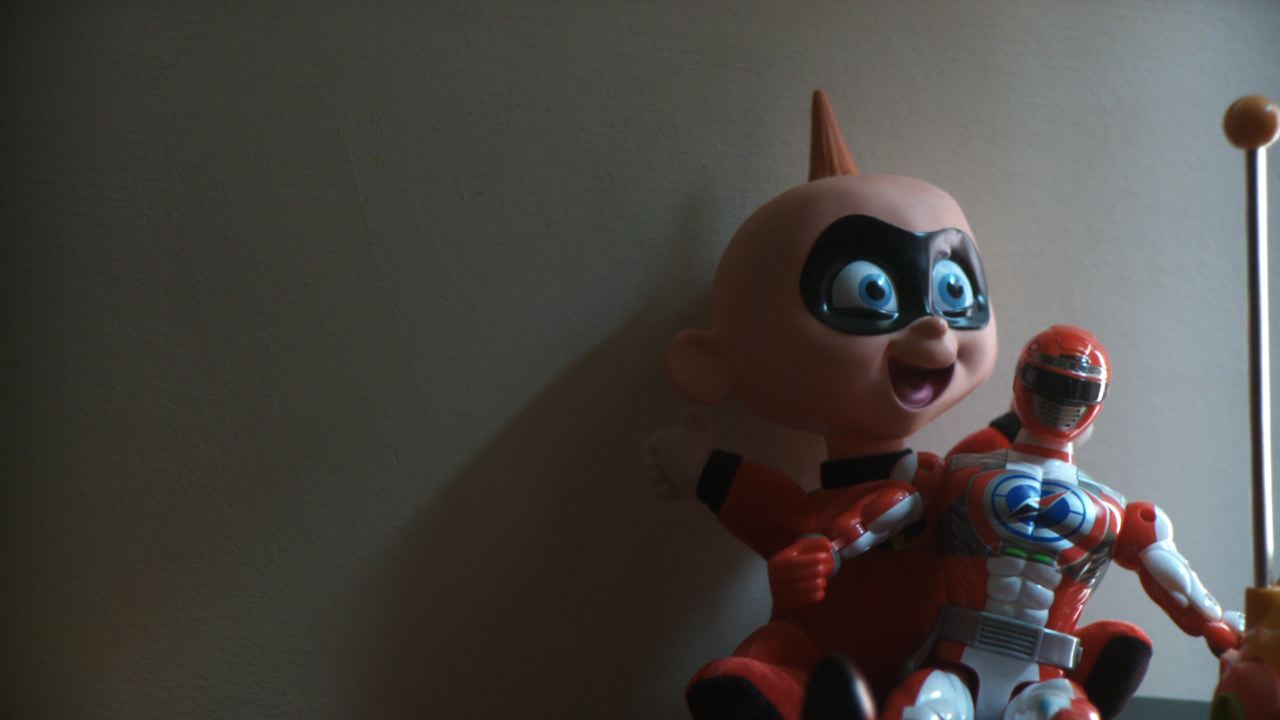

Attached are two files. Both were created with all the camera settings in manual mode. No AWB, no auto Iris, no nothing. I was shooting through a Letus adapter with a Canon 35mm 2.0 wide open. I didn't manipulate the images in any way. I transferred them to FCP via XDCAM and then exported them as still images from FCP.
One file, pictured to the left, titled EMBEDDEDPRST3600, represents a frame grab from footage when shooting toggled to PRST (at 3600k). Just to remind you, the PRST setting was originally set at 5600k, but I switched it to, 3600k through the PP menu [under PICTURE PROFILES>SET>WHITE>PRESET WHITE: 3600] before shooting the clip. The other image, pictured to the right, represents a frame grab from footage when shooting toggled to the WB "A" setting which custom white balanced to 3600k.
The difference is actually more pronounced than I could make out on the camera's monitor. Look at the shadows in the embedded preset version--they shift to cyan.
Anyway, I don't know if I'm splitting hairs here. I am mainly concerned with knowing how the camera "thinks" so that I can control it and therefore can get predictable results.

The preset white balance settings assume a pure full spectrum light source while the manual white balance will to some degree compensate for light sources that are not full spectrum or have peaks in some colours. For example light reflected by some materials or paints may not be full spectrum as some wavelengths may be absorbed by the material. Normally you would expect a manual white balance to give you the purest whites for the given lighting while the preset will give you a close approximation.
One advantage of using a fixed preset is that it can make grading easier as you have a consistent setting to start with. It is also useful for multi-camera shoots to help get all cameras to match when they can't all white balance together at the same time.

The light source is window light on an overcast day. I guess what we are trying to figure out is why two separate 3600k readings give different results. One of the readings was created and saved to the WB "A" memory, and the other is the camera's embedded preset of 3600k. I suspect the difference lay in the rounding up and down of numbers by increments of 100k. While the camera may display a numeric value of 3600k, the true value (which could be 3649, or some variation thereof) is reflected in the actual image.
As much as we want to be scientific about this, the true tolerances of WB and PPs are not as tight as most of us would like, and only a Sony engineer would be able to explain the discrepancy I've found here. That said, I've learned a couple of valuable things out of this: take care to white balance your camera properly and choose the picture profile most appropriate to the given scene. Further, keep your head about you and realize it ain't gonna be perfect but that you should be close to the desired result. In the end, it will be refined in Post anyway. The idea is to try to come as close in-camera as possible to minimize the amount of time spent tweaking in FCP later.
