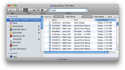

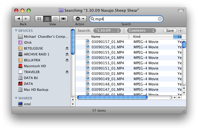

Location: Moab, UT
Posts: 264
Originally Posted by Simon Wyndham View Post
Did you make sure to highlight the folder first? .
I have no idea what I'm doing differently from you. No matter which folder I highlight, it always only gives me back the contents of the drive. In your example, it would be showing Video 1 as the only option, not the folders within it.
How did you make that screenshot?

Posts: 1,931
Can you make me a screenshot? To take mine I pressed shift+Command+4 and then pressed space (the cursor changes to a camera icon). Go over the window you want to take the screen shot of and click the mouse.
I'm on OSX 10.5.7.
Simon Wyndham is offline   Reply With Quote
Old July 2nd, 2009, 05:40 PM   #34
Location: Moab, UT
Posts: 264
Figured it out. You have to be in column view, not list view, in order for it to work. Very cool.
Any dangers you can see in renaming the clips here? One that I can see is that I took these folders off my archive drive and there's a blu-ray backup as well. If I ever had to go back to those folders for reconnection, the names wouldn't match. That's not the case if I rename in FCP. Maybe Bridge is the answer--unless it needs to rename in the finder and not in the fcp bin.
And just out of curiosity, where did that screenshot go when I clicked the camera?
www.packcreekproductions.com
EX3, Mac Pro, FCP
Mike Chandler is offline   Reply With Quote
Old July 2nd, 2009, 05:54 PM   #35
Location: Moab, UT
Posts: 264
Got it. They were on the desktop. Even though they both show list view, one was created in list, the other in column, same folder highlighted. Vive la difference.
