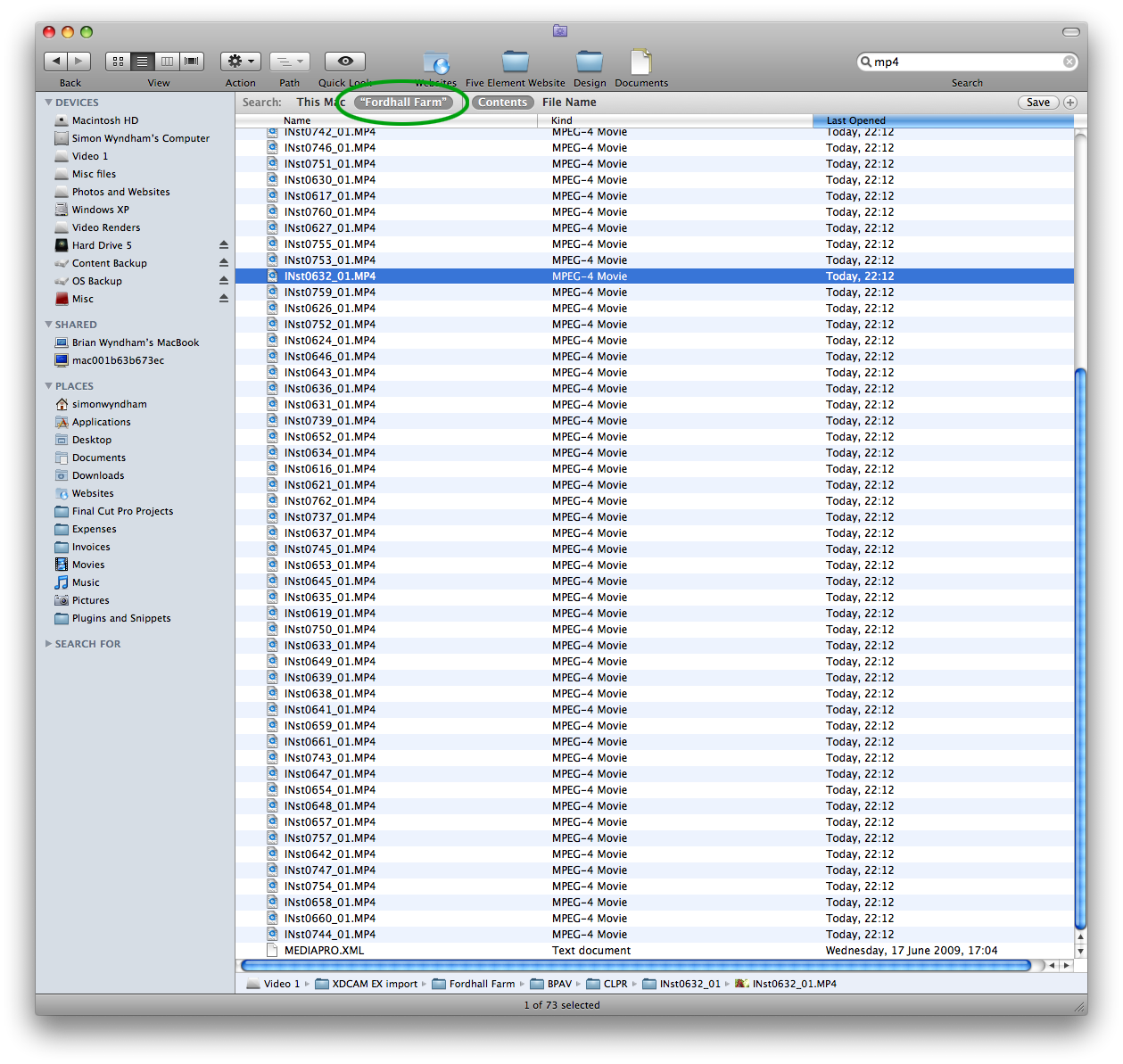

I can get it to find everything on the drive, but not within the CLPR folder. I was able to find anything in the clpr folder using "name" and the find function, but sounds like your way could be simpler.
Yeah. Open the Finder in OS X and highlight the CLPR folder or parent folder of the CLPR folder. Now type "mp4" without the quotation marks into the search field at the top of the Finder window.
This will now list all the mp4 files on that drive. However if you look at the top of the search results you will see "Search: This Mac "MyFolder"" (with MyFolder being the name of the folder that you highlighted before you did the search). simply click on "MyFolder" and the search results will list only the MP4 files in your chosen folder. You can now highlight them and drag them into the FCP bin.

And I've got a "hmm" back at you.
When I'm doing the find, it says Search This Mac , but no folder is given. There's a folder icon before Search this Mac, but clicking on it does nothing. It doesn't say CLPR or anything,and doesn't change no matter which folder on the tree I highlight.
Below Search This Mac on a different pane, I can switch between This Mac and my Hard Drive and between Contents vs. File Name, and then in yet another pane below that, I can choose on a pulldown menu between Kind, Last Opened, etc including Others, where there are a whole host of options, but Folder isn't one of them .
Any suggestions? (OSX 10.5.6)
Did you make sure to highlight the folder first? In the attached image I highlighted my root folder for the card (named "Fordhall Farm"). The BPAV and CLPR folders are contained within this folder.
I managed to sort my issue out. Although I have encountered another drawback of this plugin. When exporting a reference .mov for compressor, because FCP doesn't really natively handle mp4 files it has to render the whole timeline even if you uncheck "Make movie standalone".
Simon Wyndham is offline   Reply With Quote
