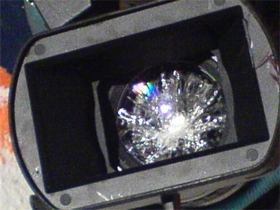

If its just the front element you might be in luck! It could be much worse. Last month a friend of mine managed to completely shatter every single element on my ex1. The repair cost about 1600 EUR parts and labor. The camera came back repaired BUT with a quite stiff focusing ring which lost focus when I zoomed in an out, so I had to send the camera back. Am still waiting. Oh boy. Here is a gory picture. Please make sure no kids are around.

OUCH! That hurts......

My EX3 hit the ground and the lens snapped in two, but none of the elements were broken. I managed to get a new lens on my insurance,
