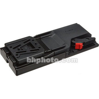

Another thing about the EX3 is the mounting plate is totally inadequate for a pro cam. I recommend getting the VF gadgets plate and vct-u14 adapter, then you can use your old sony plate on your sticks. There are other adapter plates but I like the sony plate.

Just a FYI, you know you can use a Canon TA100 Tripod Adapter instead of the longer VCT-14. You only use the front anyway with the VF plate. You don't have that extra bit hanging off the back.
Thanks Jason, I do have the Sony VCT-14 plate.
Are you saying if I buy the Canon TA100 it works/fits better with the EX3?
