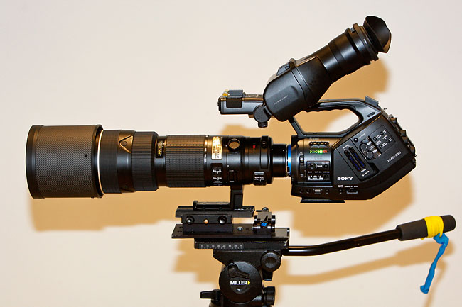

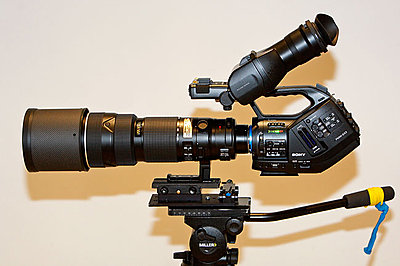

Old April 25th, 2009, 09:10 AM   #17
Location: Sydney-Australia
Posts: 443

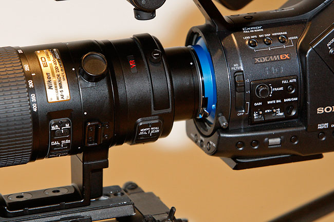

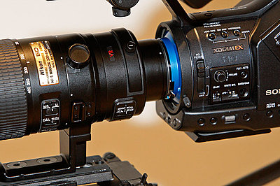

Here are two photos of my new awesome combo –Sony PMW EX3 with the Nikon 200-400 G f4 VR. The blue ring is part of the adaptor.
This is the first time the new modern Nikon G lenses can be mounted on the EX3 using Mike Tapa’s new patent pending adaptor. Mounts and Adaptors
You can now have a control on the aperture even with these lenses which don’t have an aperture ring - making it possible to enjoy the quality of the superb Nikon lenses such as the Nikkor G AF-S 200-400 f4 ED VR.
I guess there will be remarks as to the lack of a support system - I have been working with a similar system for nearly a year now and it’s just great. I will need to use a bar system just in order to mount the follow focus.
The blue and yellow rubber bands (modified balloons…(-: ) are used to control the movement of the fluid head without touching the handle.
Will post some footage obtained with this combo on my website in a few weeks.
Cheers,
Ofer
Ofer Levy Photography

Old April 29th, 2009, 05:57 AM   #20
Join Date: Mar 2008
Location: All over, USA
Posts: 512
Ofer
Are you happy with hanging the camera off the lens as shown in your pictures above?
I was thinking of two areas of concern...
1. the lens mount handling the torque
2. the vibration or shake transmitted through the brace to the lens, especially on extreme telephoto
Did you try the camera mounted to the tripod? I would think the lens weighs less than the camera and would provide less torque to the mount
Ed Kukla is offline   Reply With Quote

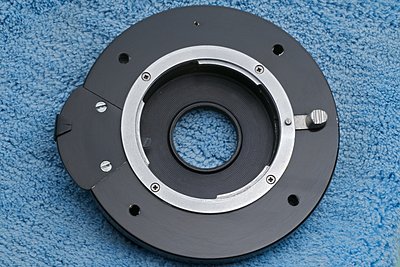

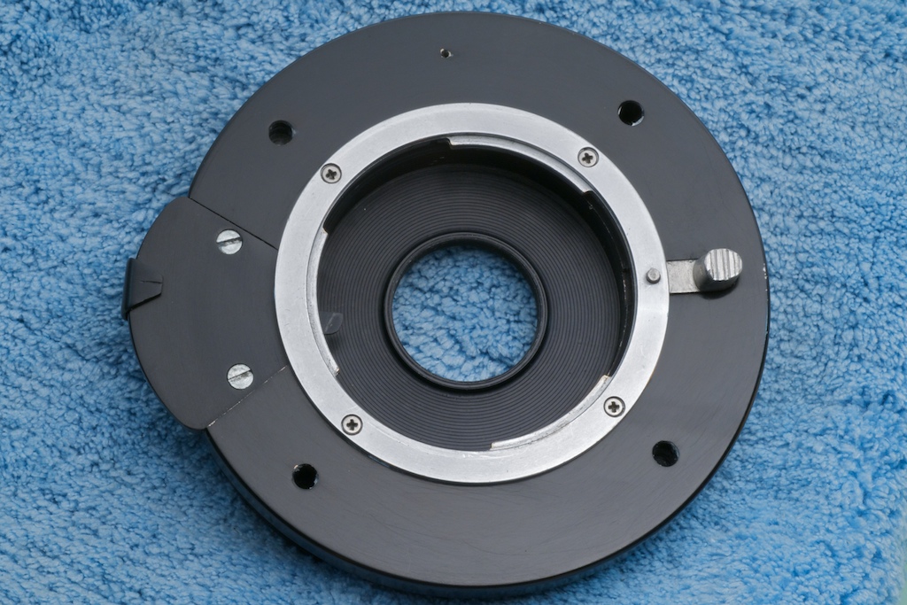

I have made a Nikon adapter for G lenses that incorporates a grooved baffle with the intention of avoiding flare issues. It was also anodised and dyed black. So far I have had no flare issues, if I do I will try flat black paint.

Old April 30th, 2009, 02:02 PM   #23
Location: Wales
Posts: 2,130
Originally Posted by Ed Kukla View Post
Ofer
Several other people have already asked Ofer that question in another thread! It does look a bit dodgy, but he's happy with it and he's obviously knows what he's doing! If it was me I'd definitely want some support though.
Steve

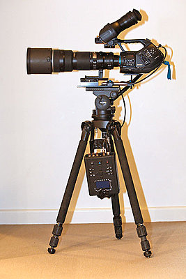

Old May 1st, 2009, 02:25 AM   #24
Join Date: Feb 2005
Location: Dorset UK
Posts: 697
There's an awful lot of trust going onto Ofers lens support mount. If he trusts it fair enough, though something like a Zacuto base plate with 15mm rods under the camera, with that large lens supported by a rod mount would be more secure IMO.
Steve Shovlar is offline   Reply With Quote

Old June 17th, 2009, 01:51 AM   #27
Posts: 443

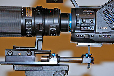

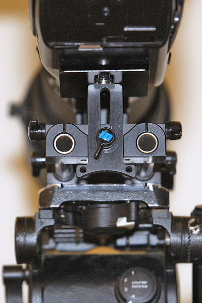

Thanks to all of you who gave me the good advice regarding the support system - you were right of course.
No damage was caused to either my lenses or to the camera's lens mount but I guess it wasn't such a healthy situation to work without a support.
Here is the simple but effective support I have been using in the last couple of months.
You can also see the whole setup including the Flash XDR.
This is such a great forum - thank you all !
