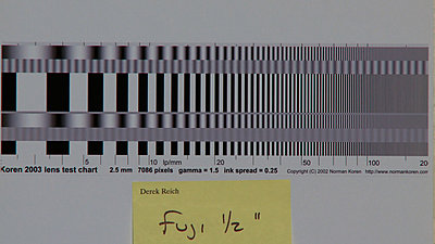

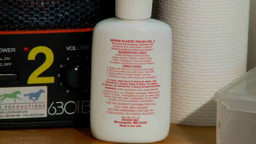

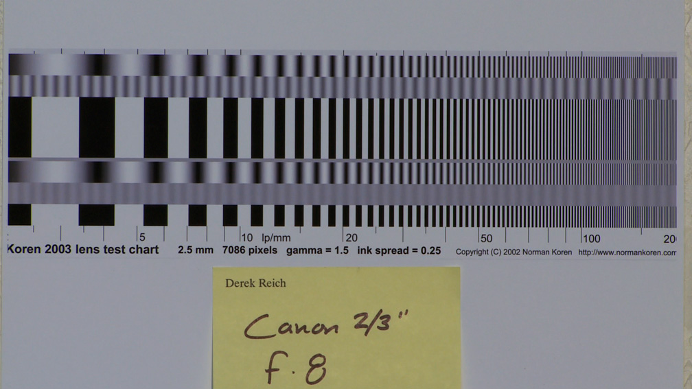

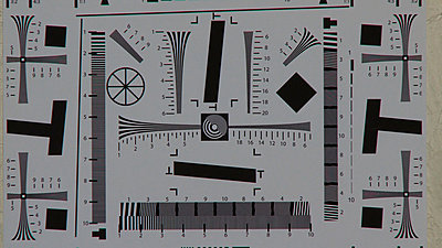

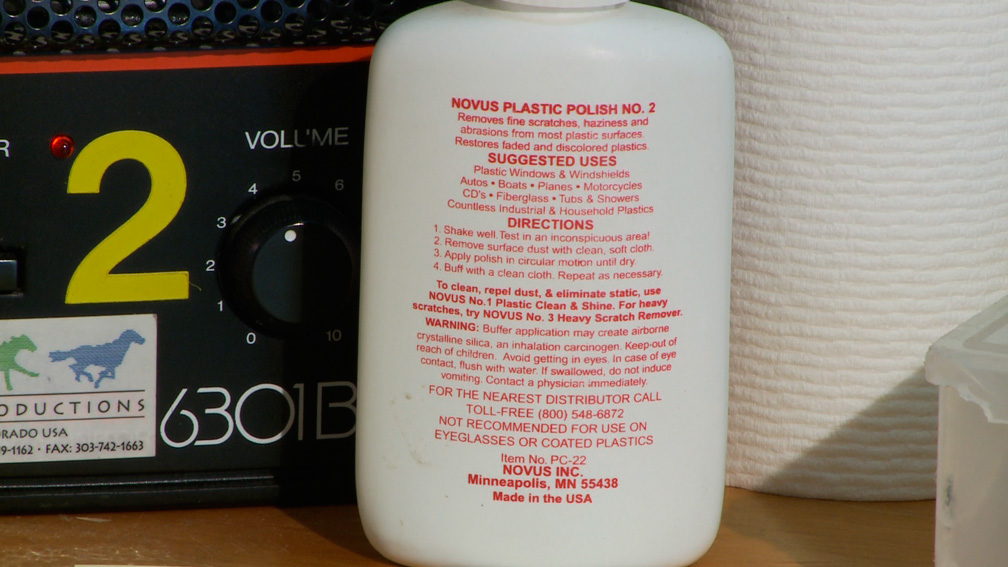

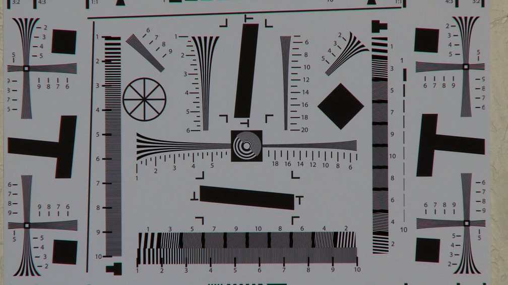

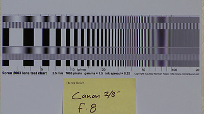

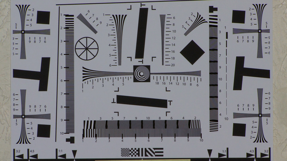

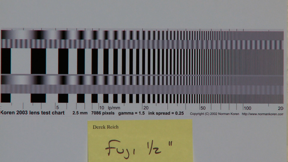

So it was quite some time ago in another thread that I mentioned that I was very impressed with the look of my Canon SD 2/3" Broadcast lens on my EX3. Someone (I think it was Simon) requested some capture frames which has taken me far too long to produce.
While packing today for a shoot, I finally (and very quickly) threw a couple of charts up and cranked out some quick clips. The following are capture frames from those clips.
I had the camera set at 1080 60i (I know, I know.... but that's what the client wants) and I just did a frame grab from the clips. I doubt this is the optimal way to compare the lenses, but at least it gives a pretty good idea of how they compare. I used the Sony 2/3" adapter (the one without power connectors, so iris is set by eye, zebras, and histogram)
Call me crazy (many do) but does the SD lens look a little crisper?
2/3" SD lens on EX3-fuji1.jpg   2/3" SD lens on EX3-canon1.jpg
2/3" SD lens on EX3-fuji2.jpg   2/3" SD lens on EX3-canon2.jpg
2/3" SD lens on EX3-fuji3.jpg   2/3" SD lens on EX3-canon3.jpg

Difficult to tell from the charts. Not sure you have the Fuji in focus on the resolution chart. Another thing to look at is contrast. I have found the HD lenses generally give higher contrast that the SD lenses I have tried, but that may be down to them being newer lenses with cleaner internal elements.
The bottom line is that there is a lot of variation between lenses. There are good SD lenses and bad HD lenses. I think the stock EX lens is pretty good considering what it costs. I also have a Canon KH20 1/2" HD lens which works very well on the EX3. My 2/3" lens experience with the EX3 and F350 (also 1/2") has been mixed. Even some of the very expensive HD lenses I have used have been disappointing.
If you have found a 2/3" SD lens that works well let us know what it is!
Old March 4th, 2009, 05:57 PM   #4
Location: San Jose, CA
Posts: 2,222
The red text on the bottle looks better with the SD. Also, the borders on the test charts look slightly better with the SD in that the markers are slightly sharper.

I did my best to make sure the Fuji was in focus, using the expanded focus on the lens. (it wouldn't zoom in near as close as the Canon)
The SD lens I am using is a Canon J20ax8B4 IRS.
