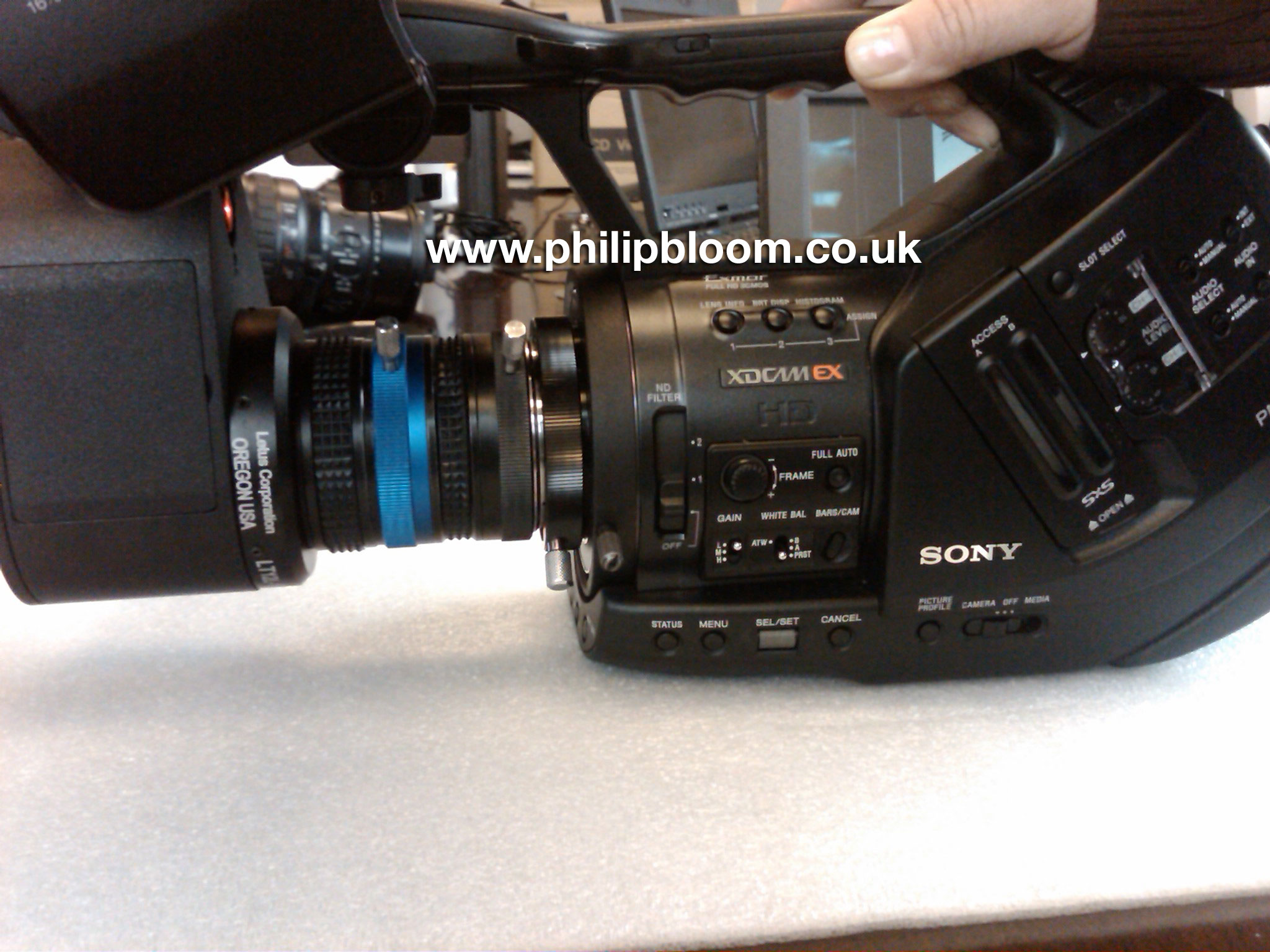

This morning I received from Hien Le of Letus, the B4 pro relay and very excitingly the long awaited EX3 relay for Letus adaptors.
It's really nice. F1.5, a little bit shorter than the Pro relay, certainly longer than the Compact relay. It looks really neat on the EX3.
i will try it out for the first time on a shoot tomorrow. Can't wait. Will report back!

please let me know how much light loss it is vs letus ultimate attached to the stock lens and if the image is sharper.
thanks!

If you get time in your busy schedule, will you do a little experiment for me.
Offer up by hand or jig the appliances together on rods if you can, the EX3 relay with Letus Extreme attached, to a 2/3" camera. You may not be able to get back far enough into the B4 mount as the EX mount lugs may foul on the sides. If this happens can you just hold a piece of paper behind the relay lens as a screen at the focal plane (sensor position) and measure the diameter of the image area. An 18mm circle drawn on the paper will make this easier.
I'm interested in seeing if the wider full frame of the Extreme groundglass can be relayed by the 1/2" lens to the 2/3" sensor without the corners going soft or brightness falling off.
If the 1/2" lens will do this, it might not be a big engineering deal to cross-configure the EX3 relay with a B4 mount so users can have that option.
You may bring in a side. If you can get a clean frame top to bottom then a recentered Extreme should work in this configuration to the SI2K. Chances are, being fine tuned to the EX3 the 1/2" relay will go slightly soft in the corners to 2/3" or even vignette.

Hi dean mate! How are you?
No it won't fit without serious mods.
Got some more pics up of it
Philip Bloom Blog Archive More pics of EX3 Letus Relay
Will try Bob!!!
