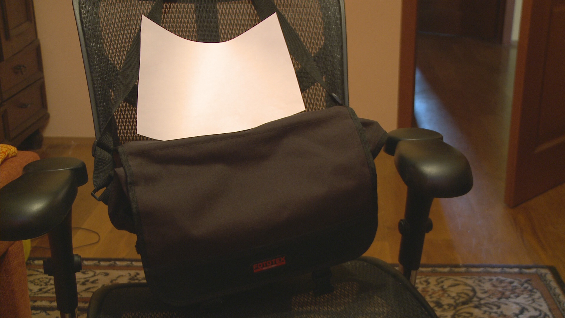

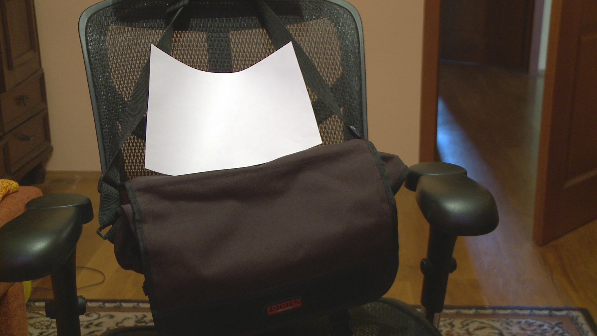

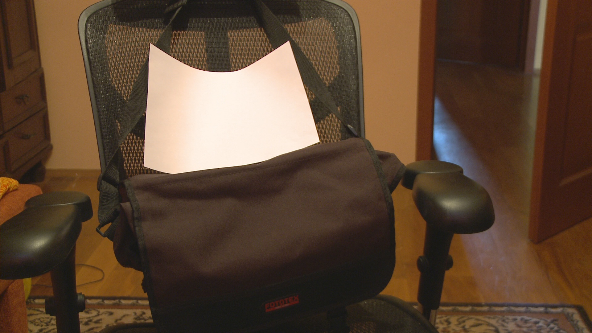

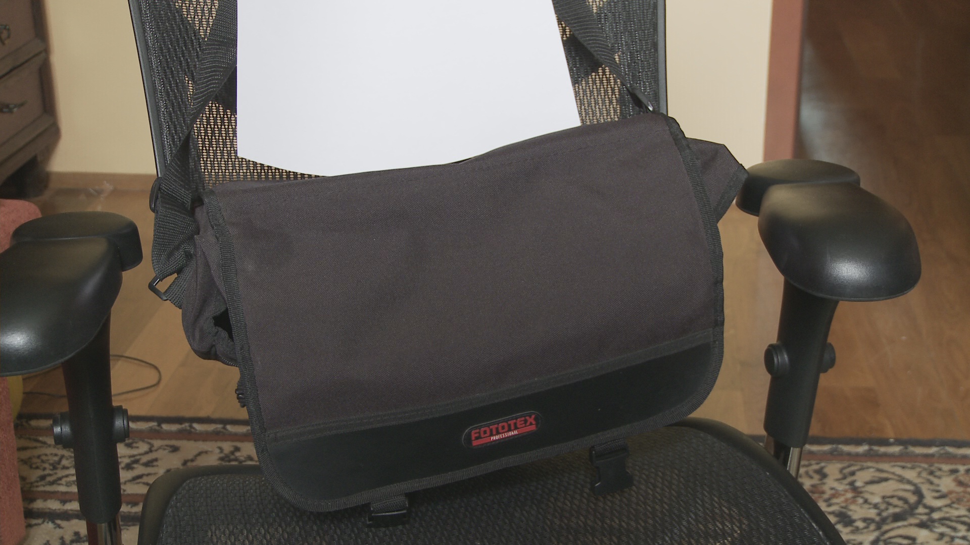

To put it simply , Adam has confirmed the nature of the problem, we still do not have a solution. Shooting stage shows with a ND1 filter on the camera even if it cured the problem is not an option, period.
I couldn't agree more with this last statement, Bob (with a little correction - we're not talking Adam Wilt's article here, but that of Art Adams :)).
However - after having tried the screw-on 486 and 489 - I'm now having a 4x5.65" filter from a manufacturer whose name I'd prefer not to reveal at the moment. I have just completed a quick and dirty series of tests, and here are my results...
1. YES, even in daylight at 5600K, the blacks CAN be a bit contaminated - just compare the first pair of my grabs (upper left - no filter, upper right - with filter X)
2. In tungsten light at preset 3200K, EVERYTHING is too red - but still the middle right picture (with filter X 3200K) shows some improvement over no filter (middle left) (BTW, sorry I forgot to re-focus on the main subject - the bag - after I had to open up the iris due to lower light)
3. As I said before, dialing WB down to 2700K (to balance at the white card) allows to minimize the red contamination (bottom left - no filter), and the filter I tested makes the black ALMOST completely black (bottom right).
Conclusions:
1) 3200K is commonly used as the right preset for tungsten lighting; looking at the grabs, it's obviously too hot - always do white balancing before actual shooting! It seems to have much stronger influence on the alleged "IR problem", than using a Hot Mirror filter...
2) The B+W 486 filter can get rid of ALL contamination (see my comparison grabs in another thread); should it not produce the ugly, greenish vignette at wide angles, it would be the best solution for the EX cameras... Just what kind of filter is it ?!!
Comments welcome!
Filter for IR contamination-no-filter-5600k.jpg   Filter for IR contamination-filter-x-5600k.jpg
Filter for IR contamination-no-filter-3200k.jpg   Filter for IR contamination-filter-x-3200k.jpg
Filter for IR contamination-no-filter-2700k.jpg   Filter for IR contamination-filter-x-2700k.jpg

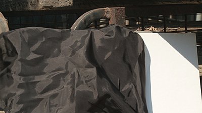

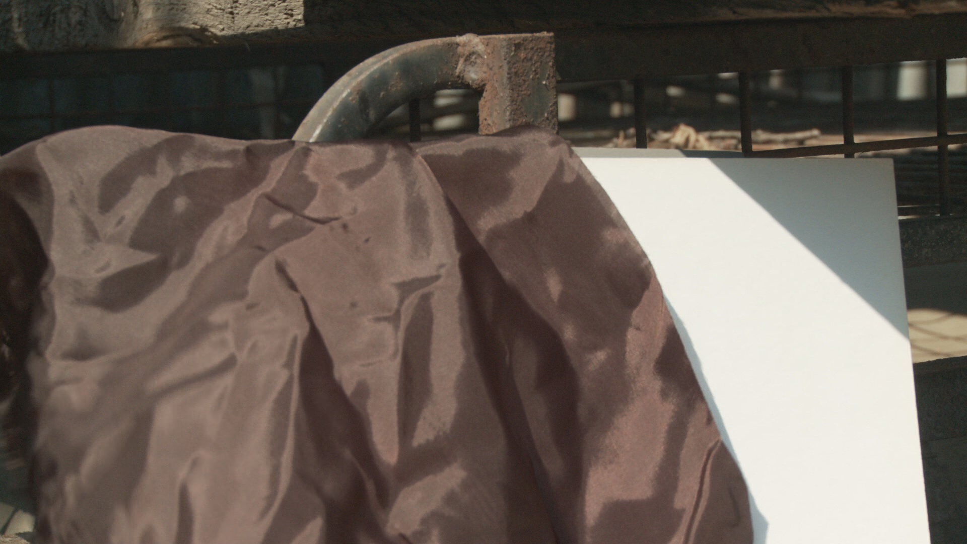

Generally outdoors I do not use any additional IR filtering (while Bob uses it as default), but it isn't true to say that the IR problem isn't present under 5600K lighting. Attached are two recorded in sunlight (white balanced internal camera ND filters) and the black artificial fibre is recorded black only with the BW486 filter.
Also, when suggesting that the default 3200K setting is too hot (which I haven't checked, I always WB) how was the colour temperature of the lights measured? Maybe they were not 3200K.
Filter for IR contamination-nd-only.jpg   Filter for IR contamination-bw486.jpg

Piotr,
I'm having trouble identifying exactly what problem your having because I don't know what lights you were using or for that matter how much background you may be bringing to your understanding. Please excuse me if it sounds like I'm talking down here.
It looks like you you shot the test of the chair under ordinary household tungstun bulbs which are not 3200 but closer to 2600- 2900K so of course the picture would appear red.
Alternatively Serena is right that if your voltage is lower than what even professional photo lamps are rated for (usually 3200) the same thing would happen.
This has nothing at all to do with IR contamination, just ordinary white balance and color temperature. IR is something that only affects some fabrics in an otherwise well color balanced shot.
It is interesting though that people with the EX on these boards have been complaining mostly about IR under Tungstun light rather than in daylight while using ND while complaints about the RED seem to center more about ND problems. I need to do some testing myself on this soon.
Its obvious that flourescents might not produce the same IR that tungstun but that is only a very limited solution for most people. Though for now might be something to keep in mind if you have an important shoot that you have the ability to shoot with flos.

Lenny,
No problem with talking down to me at all :)
I probably wasn't clear enough, but I do realize the middle 2 grabs posted above (at 3200K preset) are too warm due MAINLY to bad WB, not IR contamination. Basically, the left 3 grabs are without any filtering, while the 3 to the right - with some Hot Mirror filter I'm testing now (which only has none to mild effect, BTW).
If I discussed the 3200K preset vs 2700K measured CT with Serena has been because, in fact, I started worrying about my unit's WB presets being off - without any connection to the IR contamination.
Your post, however, helped me stop worrying as indeed, 3200K is more for a direct halogen light, and my shots were taken under regular home tungsten (plus red curtains in the window to block daylight). So, the 2700K is absolutely a more realistic figure for the true CT here!
Well, I did put a disclaimer in my post above these were very "quick & dirty" tests - but I should have taken more time (and thought) posting them, anyway!
Nevertheless, I think my conclusions still hold true:
- the W+B 486 filter I tested earlier is far more efficient than my currently being tested one, as it can get rid of all and any red contamination (I deliberately don't call it "IR"), but sadly is unacceptable due to the greenish vignetting at wide angles
- proper WB is essential for minimizing the red contamination, with a filter as well as without one
I guess you can agree :)
