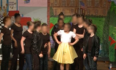

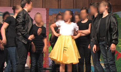

Yesterday I spent three hours recording a production of Grease, and yes most of the cast were all in black T-shirts or sweaters. My Canon footage looks fine but the Sony footage is unusable. I will now spend another three hours on Friday doing the same job.
Here are two stills from the show. (sorry, I have blanked out the faces)
Filter for IR contamination-canon-frame2.tif   Filter for IR contamination-sony-frame2.tif

I just did a school concert of Grease and the first night I recorded it without the filter and yes, most of the blacks colours were useless but the 2nd and 3rd night I recorded it I used the 486 filter and it worked out great, a big improvement.
Just had a look at the sony still Vincent and yes, thats what mine looked like too, before the filter was fitted.

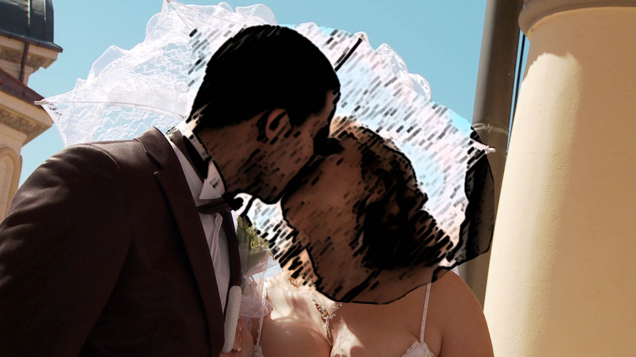

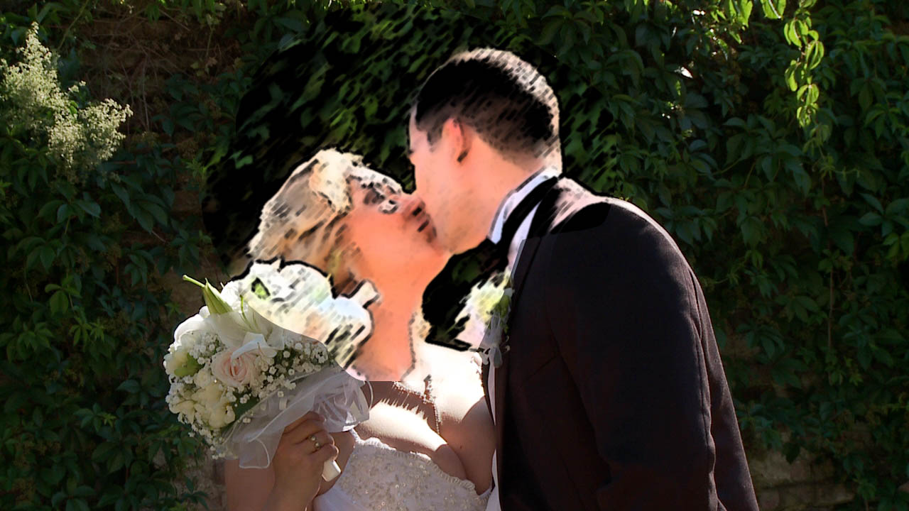

Vincent may change your opinion after you see a black coat groom :-).I just bought 486, should not be used permanently, but it's good to be in the bag when needed
