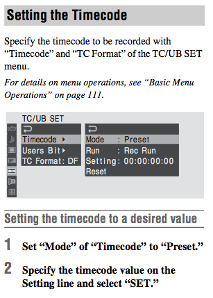

Jason: You would think! :) When I went to the timecode settings, it showed 00:00:00:00. There was nothing to reset or I would have.
Vincent: I think you're probably right. Maybe I switch to Time of Day. Thanks.
Peter: Also good advice. Thanks.
I'm going to try and figure out how to "zero" the timecode setting in the menu. I see how to do it in the manual but I couldn't find the "SET" function. But might just switch to using Time of Day. Thanks!

Go to the "Setting" option and you will find the "Set" option at the end of the timecode number. It's not obvious! I use time of day as well. Only draw back with TOD is that if you are on a shoot with a PA and they don't ask for the timecode until some time after you have stopped rolling then you have no idea what the timecode at the end of the shot would have been. The advantage is that if you get a digital watch and set it to match the time on the camera the PA can log shots using the watch. It will stay within a few seconds over most jobs and is good enough for finding most things.

Alister, you're a genius! Exactly the answer I was looking for and then some.
I can't tell you how many times I've been into the Timecode menu and never noticed that. Makes sense now that I see it. (I warned everyone that this would be a stupid question)
