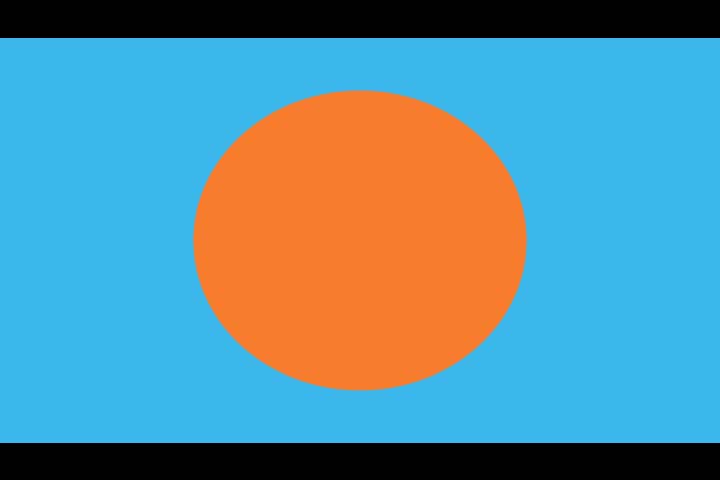

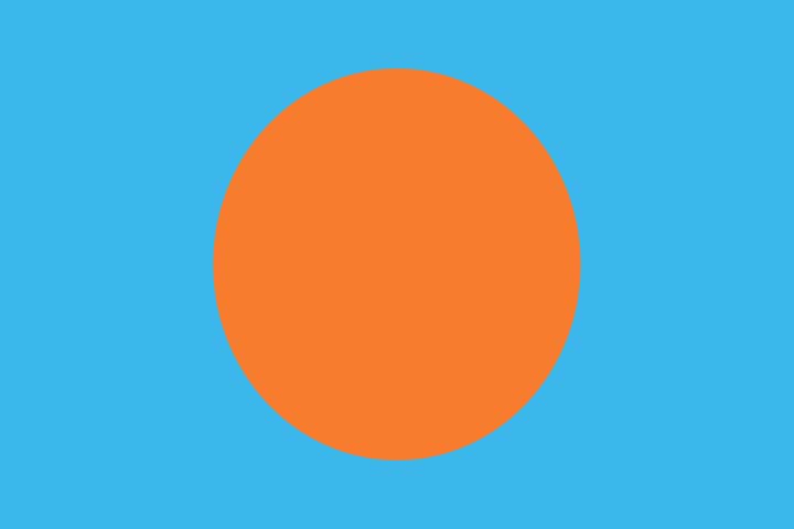

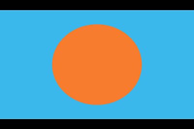

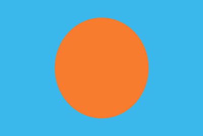

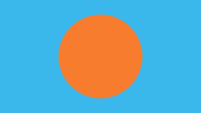

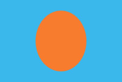

Hi Perrone/Dominik,
You are both right. However with resizing to 720x405 (Image1) you are creating a letterboxed widescreen DVD (Image2) and not an anamorphic one, so technically not widescreen at all. Which is fine for standard TVs but a waste for widescreen TVs. Checking the widescreen flag it will appear squished in the case of NTSC or stretched in PAL when viewed on a widescreen TV and a 16:9 configured DVD player. At least that is what is meant to happen.
To get anamorphic widescreen resize to 720x480 (Image3). It shouldn't look right on a computer but with widescreen flag set will look perfect on a widescreen TV (Image4) without loss of vertical resolution.
Different frame rates and sizes for the EX1?-720x405.jpg   Different frame rates and sizes for the EX1?-letterboxed.jpg
Different frame rates and sizes for the EX1?-720x480.jpg   Different frame rates and sizes for the EX1?-anamorphic.jpg
Omar Idris is offline   Reply With Quote

Indeed if you are authoring widescreen DVDs correctly your clients with upconversion players will love you. If you do the incorrect 4:3 letterboxing you'll look like an amatuer! A lot of older DVDs were made non-anamorphic and it's a little distracting to watch on a big screen HD television.
If I assume that Perrone knows what he's doing, then he wasn't working in his example with 16:9, but with 2.1:1 footage. Because 2.1:1 would result in 720x405 pixels on a NTSC-widescreen-DVD.
But of course it is suspicious that 720/405 = 16/9. That actually was the base of my initial guess that Perrone doesn't know what he's doing.
