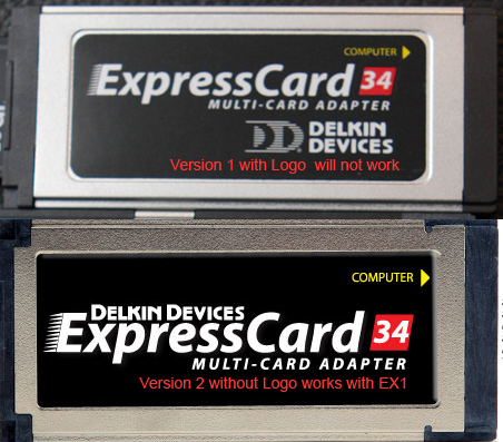

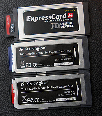

I have tried the Delkin adapter before purchased from Fry's electronics got change media error this is one on the first adapters that I tested but it was with a patriot card. I decided to go back to Fry's and try it again same thing change media error the card did not fit inside the adapter it stuck out even further than the Kensington. They must have revised the design have any of you guys tried the Delkin.

Brian, there seems to be a version 1 and a version 2 (the one needed for the EX1).
However, I have not yet found a hint how to differentiate those two version.
Edit: Just read in the other forum that the older Delkin reader has the Delkin Device logo on the front and the SDHC card does not insert flush (above called version 1).
The new Delkin card reader does not have the logo on it and the SD card DOES mount flush (above called version 2). That's the one and
only that works with your EX 1. Thx GB.

Ok thanks the box is exactly the same could not find a model number. but I see what you mean about the logo going to return this one today. I will check to see if Fry's has this version.

Thats the pic from the box same pic is on the version one and version two box you will have to look at the actual card.
